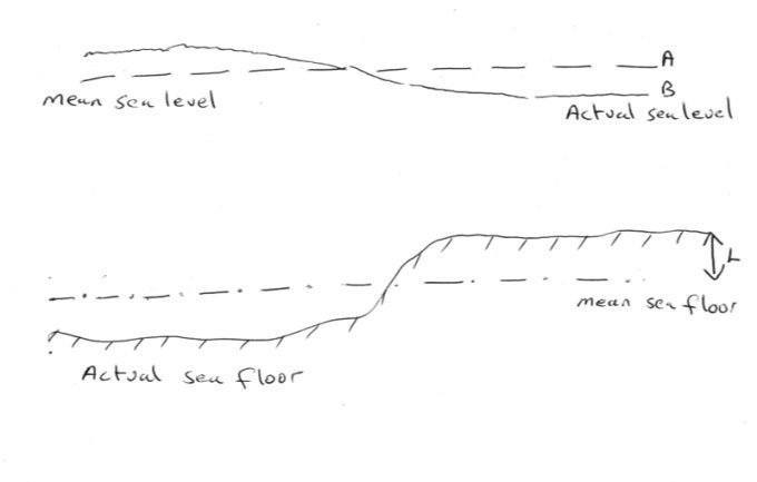

I like diagrams so here is one.
With the aid of this diagram and our definition of sea ground (thank you hamster) I think I understand what the teacher was proposing so I will explain my understanding of this proposal for further discussion.
The diagram show a section of varying sea floor and the water column above it. The proposal is that where the sea-floor is above mean sea-floor level the actual sea level is below mean sea level.
The reason is suggested to be an increase in gravity at local sea level, perhaps because the lump of land marked L is much denser than the equivalent volume of water.
Of course, so long as our test mass is small and outside the mean solid surface of the earth, gravity increases as we approach this mean surface. Gravity is naturally stronger at B than A anyway, since it is closer to the centre of the earth.
That doesn't make sense. Actual sea level differs from mean sea level because of the tides, not because of some gravity anomaly. Remove those tidal effects in one way or another (three ways; see my previous post) and what will be left is some form of mean sea level. The geoid, at least over the oceans, *is* the surface corresponding to mean sea level.
The difference between the geoid and the reference ellipsoid, the diagrams linked by hamster and I, essentially reflect the fact that the Earth's surface and material close to the Earth's surface (close meaning up to 200+ km deep) is dynamic over the scale of tens of thousands of years (isostatic rebound from the last ice age) and even tens millions of years (tectonic activities such as the collision of India and Asia).
