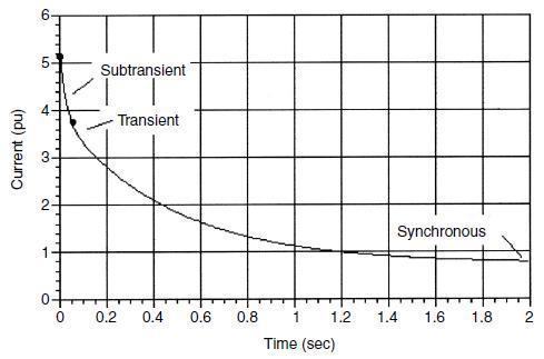

please explain the transient and subtransient reactance of synchronous machines

i have learned that it is concerned with the induced current in damper winding and field winding of synchronous machines..which is divided into transient period and sub transient periods
Generator fault current is normally discussed in terms of “subtransient,” “transient,” and “synchronous” currents and impedances. These terms refer to various time periods during the decay of the AC component of current. Attached Figure plots the envelope of the AC current for a typical machine. The subtransient current, reactance and related time constant defines the AC current component from the inception of the fault and the following cycle or two. This is the maximum available AC short-circuit current from the generator. Synchronous quantities define the final or steady-state current. The transient parameters define the interim current.:rolleyes:

thank you m.s.j. could you please explain how generator fault current arises?
is there any kind of flux variation during the transient state n in the final steady state ??
Any emf without flux variation is impossible. Please more explain.
