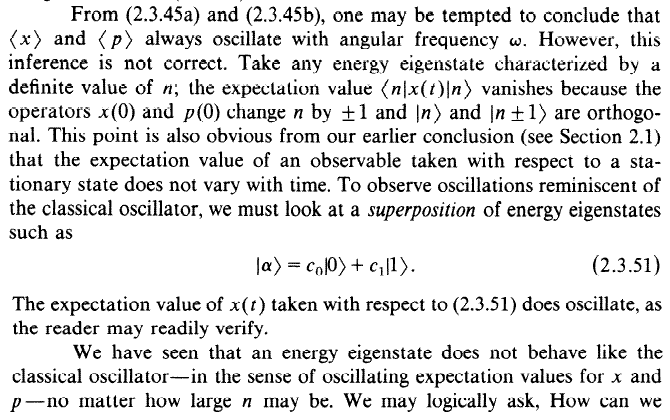

Note that the phase of the wave function is not observable! So the frequency of an eigenstate is not something you can measure. Here are a couple observables for the infinite square well:
-the difference in energy between the nth energy level and the mth
-the probability density of the nth state
I claim that neither of these change if you shift the floor of the potential by a constant.

There are several problems here: In the case of photons the frequency that is observable is the change e.g. of electric field with time. This does however not refer to a single photon but to a coherent superposition of photon number states. Hence what determines the frequency is not some absolute energy (which does not exist) but the energy difference between states with n and n+1 photons. The same holds true for the momentum.
For the electron the situation is different in two respects: 1. An electron is a fermion and states with different particle number cannot be superposed to form a coherent state which would give rise to an observable field. Hence the frequency cannot be observed directly.
2. Electrons have a rest mass, hence the dependence of E (or f) on p (or lambda) is nonlinear. Hence one has to be more precise about how to define velocity. The usual velocity of a particle is the group velocity which is dE/dp. The velocity E/p is the phase velocity and can be seen to diverge for p->0 as E=mc^2 in that limit.
I just got to the relevant bit of Sakurai. I think the attachment is what DrDu is referring to. Right?
Adrian.
Yes, that is exactly what I am referring to.
