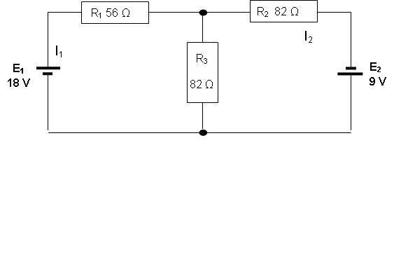

Hello Folks,

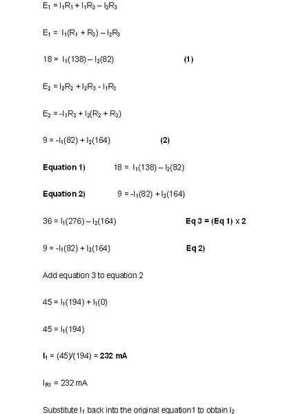

I have attached a DC circuit consisting of two opposing batteries and 3 resistors. The first step I took was to speculate on the direction of currents in both loops. I assumed the direction of conventional current for both loops, knowing full well that the maths will tell me if its correct by the operator in front of value. My results show that the middle branch has no volt drop across it as both currents are 180 degrees out of phase. The total voltage in the circuit is the sum of the two batteries. Is that a correct? I would really appreciate your help. Thanks in advance.
PS: I have attached the circuit and my solution.
I am a newbee so please be kind :smile:

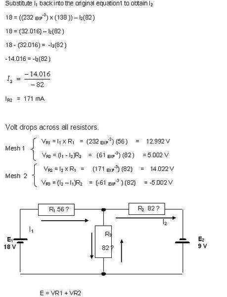

You have the right results, but the current in the middle resistor is 61 mA. This current is not canceled out.
It just appears negative in one case because the loop is going in the opposite direction.

Thanks again, however some slight confusion still, if the volt drop across resistor is +5, then as that was my only minus result that's the only current which was in the opposite direction to that initially assumed. The sum of all volt drops would then equal 32V.
However if individual loops are considered as I have done in my solution the loops make sense, however the entire circuit does,nt.
I am sorry for keep asking you have already probably answered however I fear I can not follow clearly.
It may help to work out the currents just using Ohm's Law now that you know the voltages across each resistor.
Don't forget that +5 - (-9) = 14 volts.
You can then work out the current directions because conventional current flows from positive to negative.

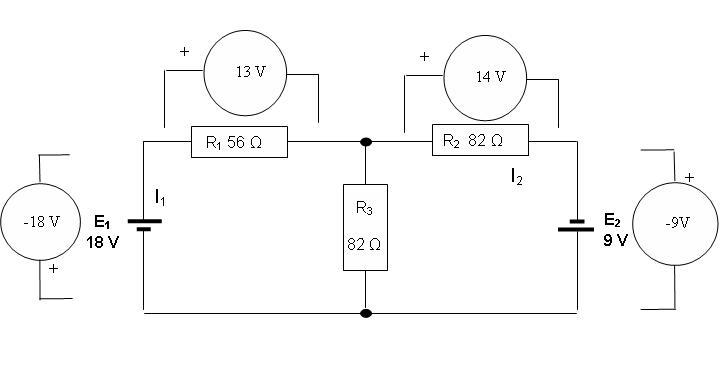

Hello again,
I have drawn voltmeters across the resistors and I still can not get the voltage across the common resistor to match. I can get it to match when measuring with respect to each loop i.e. +5 for left loop and -5 for right loop. It looks to me as they it should be 0 to satisfy the entire circuit but surely that can not be right.

Jag1972 said:
Hello again,
The voltmeter across the 18 volt battery shows the wrong polarity.
So, starting from the bottom left, and going clockwise, you get
0 Volts,
plus 18 volts from the battery gives +18 volts,
minus 13 volts gives +5 volts at the centre,
minus 14 volts gives -9 volts
then back to zero.
