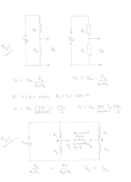

To help understand bridges you need to start with potential a divider.
This is a very simple circuit, which consists of two circuit elements connected in series with a supply. An output is taken as the voltage across one of them.
I have shown this in Fig1.
For purely resistive circuits a DC supply will suffice.
For circuits with capacitance an AC supply is required.
The output is some fraction of the input, depending upon the relative values of the two components as shown in the example calculations beneath Fig1.
Note how the calculations compare for DC and AC.
Now if we connect two such dividers to the same supply, something interesting happens.
I have shown this in Fig2.
If the ratios are the same for both dividers then the output voltage is the same fraction of the supply for both.
In other words they are at the same voltage or there is no voltage diffrence between them.
So if we connect a detector or a wire between these two points no current will flow.
This arrangement is called a bridge and the condition where no current flows is called balance.
Note that there is no requirement for the resistances (impedances) to be the same, just that the ratio is the same.

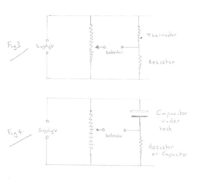

So how do we use this in practice?
Well if we make the left hand divider from a radio type volume control we can adjust the ratio to achieve balance as shown in a detector connected between the unknown resistor or capacitor. The setting on the control knob then tells us the value.
Alternatively, for small deviations from balance, the difference in output is directly proportional to the change in capacitance or resistance, so we can read this on a meter.
I have shown this in Figs 3 and 4.

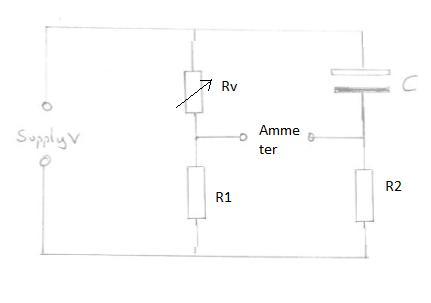

I recently attempted the RC circuit method, where I tried to use a oscilloscope to calculate capacitance through time constant. However, this method failed as the capacitor had capacitance of 0.1microFarad, making the charging/discharging time too short for measurement.
At the moment, what I have in mind is something similar to fig. 4 in your attachment, but instead I will use a variable resistor to control the ratio. I intend to submerge the capacitor in a beaker of oil, which will be placed in a water bath, thus allowing me to quantify temperature via usage of a thermometer.
A low tolerance leads to lower uncertainty in the capacitance value, right?
Correct me if I am wrong, but according to my calculations, if I were to use a 0.1microFarad capacitor at AC current frequency of 10kHz, then:
(Refer to diagram)
When balanced:
Rv/R1 = (1/2piFC)/R2 = 1/2piFCR2
F refers to the frequency of the signal. Note that the variable resistor has a range of 1-10 ohms.
When R1 = 0.33 ohms, R2 = 10 ohms
Subbing in the values:
Rv/0.33 = 1/(2pi x 10000 x 10^-7 x 10)
Rv = 0.33/(2pi x 10^-3 x 10)\
Rv = about 5.3, which falls into the range of my variable resistor.
Is there anything wrong with this setup?

In my opinion 10KHz is too high a frequency.
Bridges like this usually operate in the range 400 to 1000 Hz.
Also you bridges values seem very low. Have you calculated the current draw?
I'm sorry, but what is current draw?
I tried lowering my frequency to about 150, then used 0.1ohm for R1 and 200 for R2, but the multimeter couldn't seem to detect changes in the current significantly. Does this have something to do with current draw?
I am not at all suprised. To see why look at Fig5.
With a 10 ohm pot at minimum (=0) in series with your 0.1 ohm resistor across the supply you have effectively shorted your supply.
Let us say the supply generates 1 volt. In principle it would need to supply 10 amps.
You need a resistance in the range 5k to 50k for the pot.
It is simpler to connect it as I have shown - you don't need a very fancy bridge.
This also has the advantage of a reasonable fixed current draw so you don't have any worries about this. If you make the pot of too high a value you will have detector problems as the detector needs to have an input resistance of 10 times the pot.
As regards the frequency, yes 150 Hz will work, but try testing your multimeter with just the sig gen attached. most multimeters will go up to several hundred Hz or even 1KHz.
If it is a digital meter then connection polarity is not a problem, but if it is a meter with a needle (analog) then you need to realize that depending upon whether you test capacitance goes up or down will determine which way the meter deflects. Bridges often used a centre zero meter for this reason so the needle could go either way.
Finally I suggest you use a second capacitor, of basically the same value as the test one, rather than a resistor, in the other half of the bridge. This will make setting the intial balance easier and place it somewhere near the centre of the pot range.
The beauty of projects is that there is no fixed 'right answer' like questions from a textbook.
You are gaining valuable experience and hopefully learning by doing this.
Keep it up.

I understand that the current will be split between the two sides of the bridge, and that the sum of the p.d across the Rv and R1 will be split according to their impedance. A low resistance would lead to large current. However...
I don't quite get this. Are you saying the large current is affecting the detector's ability to measurem the current passing through? I thought the size of current passing across the multimeter is a result of the potential difference between the sides of the bridge is proportional to the extent of imbalance of p.d. across the bridge?
Yes this is true. But that assumes you have a potential difference to start with.
Look again a fig5.
We don't have a bridge here. Just a 10 ohm pot connected inseries with a 0.1 ohm resistor across the supply. You haven't specified the supply, but I have suggested 1volt.
When the pot resistance is at its maximum the total resistance across the supply is 10.01 ohms so 1/10.01 amps ie 0.1 amps flows - so long as your supply can manage this.
When the pot is at its minimum resistance then the load across the supply is 0.1 ohms so 1/0.1 = 10 amps flows again within the limits of the supply.
Now I am assuming we are talking about a standard signal generator ( remember I asked about your resources?).
I don't know of many signal generators capable of supplying 0.1 amps, let alone 10. Somewhere between 0.001 and 0.01 amps would be nearer the mark.
This is one of the reasons why I suggested Fig6. Here there is a constant resistance that does not overload the signal generator.
Now move on to Fig7.
If we choose to use an ammeter (galvanometer) as the meter we must balance the bridge. That is adjust the meter reading for a minimum.
This is because the (ideal) impedance of a current meter is zero. Practically it is very low.
So even a small imbalance in the bridge ( = difference in voltage) will lead to a large current reading.
And you must rebalance the bridge to take each reading.
By the way does you multimeter offer AC current ranges?
Not all do.
So I suggested an alternative whereby we use a voltmeter not a current meter.
An ideal voltmeter has infinite impedance so very little current will flow. However for small changes in the component values in the bridge the voltage reading will be proportional to the change, which is what you want to measure.
So you will not have to keep rebalancing the bridge in order to take each mesurement.
