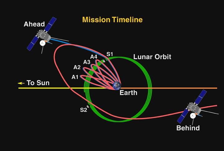

cjameshuff said:
Fire a payload into a trajectory that chases the moon at apogee, and perigee might be lifted enough to miss the atmosphere, but there will be more close encounters with the moon at apogee leading to major changes in the orbit over time.
Or the payload might be ejected from the Earth-Moon system. This is exactly what happened with NASA's STEREO satellites.
The two satellites were launched together on October 26, 2006 into highly elliptical orbits with apogees beyond the Moon's orbit. The initial orbits of the two spacecraft were nearly identical. The two spacecraft swung rather close to the Moon on December 15, 2006. STEREO-A passed closer to the Moon than did STEREO-B and thus received a greater gravity assist than did STEREO-B. The fly-by gave STEREO-A enough energy to eject it from the Earth-Moon system. STEREO-A now orbits the Sun with a period of about 344.5 days.
STEREO-B did not receive quite that much energy from its December 15 fly-by. It instead remained in orbit about the Earth+Moon system, re-encountering the Moon on January 21, 2007. This second fly-by gave it the extra boost needed to escape the Earth-Moon system. STEREO-B now orbits the Sun with a period of about 389 days.
