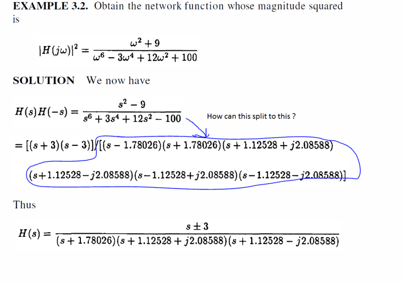

the problem that i attached bellow is related to how you can obtain a transfer function from its squared magnituded.
my question is not on the problem it self as its just a solved example from my book.
what i find difficult to understand as you can see from my attachment is how the 6th degree polynomial was break down to equations that involves complex number.

You could easily find the six zeros of the polynomial in the denominator using software such as MATLAB and then write it as a product of its factors, given that (s-k) is a factor of a polynomial f(s) if and only if f(k)=0
I know how to solve it with matlab. But I need to know how I can do it on paper.
