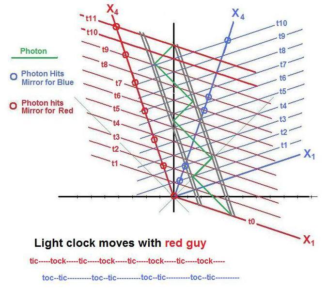

A four dimensional photon filament zig zags between the 4-D surfaces of a light clock in a rest system. A 4-D red observer and 4-D blue observer are straight lines slanted symmetrically with respect to a rest system. The photon start point is at zero time (t0) for the blue guy (photon departs from the right surface), but the start point is at time t1 for the red guy. The photon next hits the left surface at t4 for the blue guy, but hits that same point on the left surface at t3 for the red guy. The photon next contacts the right surface at t6 for the blue guy and t7 for the red guy, etc.
The blue and red guys cannot agree on the times corresponding to the photon points of contact. However, they both agree that at all times, the photon was moving at the speed of light, c (photon 4-D filament always bisects the angle between the X1 coordinate and the X4 coordinate for both blue and red--the ratio dX1/dX4 is always 1).

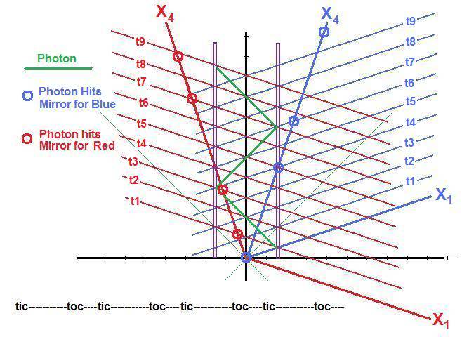

You are right that the Wiki diagram is a little confusing. I thought an animation might be clearer but surprisingly there are not many on youtube. This is the best I could find but it might suffice. http://www.youtube.com/watch?v=XhJitbhsKvI&NR=1
Clock ticks regularly for the red guy since the clock is at rest as far as the red guy is concerned. The blue guy sees the clock moving away from him and ticking irregularly.
Now, sitting back with a bird's eye view of the 4-dimensional universe there is nothing confusing. The blue and red guys simply do not experience the same instantaneous 3-D cross-section views of the 4-dimensional universe. By constructing this type of 4-dimensional universe (photon 4-D filaments always bisect the X1 and X4 coordinates for all 4-dimensional observers), nature has ingeneously assured that the laws of physics work the same for each observer, no matter how his X4 coordinate slants (in any reference system you choose). Nature has woven a fabric of 4-dimensional filaments in a special unique pattern that obeys geometric relationships that are manifes to us as physical laws.
If you regard the universe as 4-dimensional and all objects (including bundles of brain neurons) as 4-dimensional as well, then you might raise the question, "Who or what is doing the moving along the observers 4th dimension at the speed of light?"
