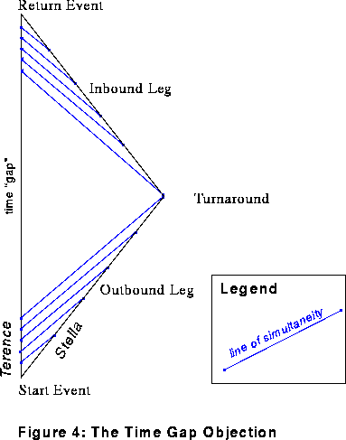

I am new to relativity, believe I have a grasp on some key points. I get that the twin that accelerated away, came back had a slower running clock...but...
I was thinking about two other people (twins not required) who from point A both accelerate evenly away, one to the 'left' , the other to the 'right' for some period, then return back to point A symmetrically.
We are told that both would 'observe' the other's clock to tick 'slower' both while moving apart and while coming back together as the other is moving relatively.
I can't get my head around the surprising looks that each have when they find out that the other's clock reads the same as theirs ? or does it ? What am I missing ? (something simple I assume) but I'm stumped...

That's not correct--only inertial observers are supposed to "observer" that clocks in motion relative to themselves run slow (as measured in their own rest frame), the same does not apply to accelerating observers.

Sorry, I shoud have said they accelerated 'briefly' then were not under acceleration just moved for say a year in opposite directions, then acclerated briefly and came back. During the whole 2 year period apart from brief acceleration did they not 'observe' the other's clock as running slower ?

During the period where they were moving apart inertially, each observed the other to be aging more slowly in their own inertial rest frame during that period. And during the period where they were coming back towards each other inertially, they each observed the other to be aging more slowly in their own (different) inertial rest frame during that period. But because of the relativity of simultaneity, no matter how brief the acceleration, there will be a major difference between (age of other twin in my current inertial rest frame immediately before accelerating) and (age of other twin in my current inertial rest frame immediately after finishing accelerating). For example, if you and I move apart with a relative velocity of 0.8c for 10 years according to our own clocks, and then instantaneously accelerate so we're moving towards each other with a relative velocity of 0.8c for another 10 years according to our own clocks, then in my rest frame during the outbound phase, immediately before the acceleration I have aged 10 years but you only have only aged 6 years, but then in my rest frame during the inbound phase, immediately after the acceleration I am still 10 years older than when we departed but you are now 14 years older than when we departed, and in the next 10 years you will age another 6 years in this second inertial frame, so you'll be 20 when we reunite and I'll be 20 too. Ages never "jump" like this in any single inertial frame, but here you are trying to switch from one inertial frame to a different one midway through the trip, and the different frames define "simultaneity" differently so they disagree about what event on your worldline was simultaneous with the event of my instantaneous acceleration.
The twin paradox page has a similar analysis based on simultaneity (though of course they are analyzing a situation where only one of the twins accelerates), in the time gap objection section, and in the too many analyses they have a helpful diagram:
If you aren't already familiar with the "relativity of simultaneity", it's important to learn, as almost all the "paradoxes" people come up with in special relativity are based on a failure to understand this notion. The wiki page I linked to above has a basic intro, as does this page. You might also take a look at the various introductions I listed on this thread.

Whenever a traveler (who might be unaccelerated almost all of the time) suddenly changes his velocity, he will conclude that the age of a distant person (who is located along his direction of motion) suddenly changes (by a large amount, if the distance is large). If the acceleration is TOWARD the distant person, that person will suddenly get older (according to the traveler). If the acceleration is AWAY FROM the distant person, that person will suddenly get younger (according to the traveler). (The distant person's perception of the progression of her own age is of course unaffected by the accelerations of anyone else).
The total of the age changes of the distant person during the traveler's accelerations, added to the total age change of the distant person during the traveler's unaccelerated segments (given by the well-known time-dilation result), will always agree with what the traveler sees with his own eyes, when and if he is ever co-located with that distant person in the future.
