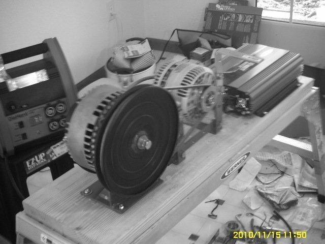

What I'm trying to do is using a motor-alternator setup to replace solar cells because of the lack of consistent sun light in Missouri. Wind power is also unreliable where I live.
I built such a device last year.
Though it's purpose was a bit different.
The last experiment was to determine how much power was being lost by the fan belt.
It turned out to be around 100 watts.
I decided that either direct drive, or a more flexible serpentine belt would be more efficient.
Thanks,
Here's what mine looks like:

This is a better picture of it:
[PLAIN]http://oneoleguy.com/images/Generator Prototype.JPG[/PLAIN]

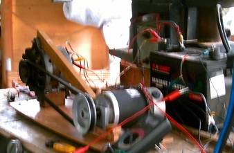

I finally installed my ammeter and tested the setup this morning. The results are:
1) -12 amps with only the motor running
2) -30 amps with the motor and alternator running.
My initial thoughts were that the alternator should be putting out something, then the ammeter reading would be greater than a -12.
I've had the alternator checked out and it was working.
I connected 2 12 volt battreries in series to the motor and the alternator on it's own 12 volt battery "not in circuit" with the motor still puts out negative amps. I've checked the ammeter connections several times to ensure that I connected it correctly and the wires are "as shown" in the ammeters schematic. How does an alternator put out negative current?
This is the information that I have on the alternator:
FORD CARD AND TRUCK High OUTPUT
200 Plus Amp One-Wire Alternator
* Ford 3G conversion alternator w/v-belt & serpentine pulley (Large Case)
* 200 amp
* Internally regulated
* OEM hookup
* Excellent output at idle
* Dual internal fans
After several attempts, I finally got the motor and alternator on separate batteries. The alternator is putting out -3.4 amps. I had the alternator checked two places. 1) at a parts house which said it was bad and 2) at an alternator shop which said it was good.
There are 2 wires going to the regulator from the alternator, what would happen if I reversed the wires? Blow it up of fix it?

Before I hooked up the motor to my alternator,
I spun the alternator with a power drill. As soon as I energized the field windings, the counter torque ripped the drill out of my hands.
Sometimes, the maths of physics needs to be b****-slapped up the side of your head, so you really know what those numbers mean.
