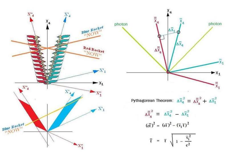

Brian Cox is a pretty smart fellow. He begins discussing this matter at about 1 minute into this short video clip. Take it from him, if not from me ...
http://www.youtube.com/watch?v=CGetCESW-dM"
GrayGhost
Just finished watching the video with Brian Cox. Thanks for that one. I had not seen it and thought he did an excellent job of presenting the classical special relativity picture of the 4-D universe populated with 4-dimensional objects.
I felt that when he brought in the quantum mechanical picture with the help of his colleague, they did nothing to explain how you get "becoming" phosophy back again without a contradiction in accounting for the 4-D objects. Just because the 4-D space is grainy doesn't mean it couldn't still be 4-dimensional. Just because the laws of physics cannot accurately predict the paths of world lines in the future does not mean that they are not there, any more than the classical SR world lines are there. The world lines can still be there... they are just grainy. I felt that was a very weak aspect of the presentation.
