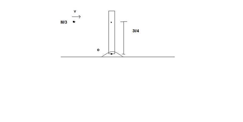

A uniform rod of mass M and length l is hinged at point O as shown in fig. A small particle of mass M/3 strikes the rod with velocity v at a distance 3l/4 from O and sticks to it. Find the value of v such that the force exerted by the hinge on the rod just after the impact is 0.
There are two forces exerted by the hinge, namely normal force and force due to impulse.
What will be the direction of the force due to impulse? Which force should be 0 according to the question?

Use conservation of angular momentum about the pivot to find the initial angular velocity.
Then use conservation of angular momentum about the combined centre of mass to find the initial torque at the pivot (and equate it to zero) …
what do you get? :smile:
what is the direction of acceleration of the centre of mass? :wink:
I did that before posting :smile:
Torque = F*9l/16, where F is the force exerted at the hinge/pivot.
Equating it to 0 gives F=0. What next?
hmm … I didn't put that very well last time :redface: … I should have said:
Use conservation of angular momentum (about the combined centre of mass) …
if the impulsive torque is zero, then you know that the angular momentum will be conserved! :smile:

Use conservation of angular momentum ( about the combined centre of mass )...angular momentum will be conserved.
Both imply the same thing. I don't get you.
Yes, the second is only there to explain to you why the first works. :wink:
Ok...
By conserving the angular momentum about the combined centre of mass,
M/3*v*(3l/4 - 9l/16) = Icombined C.O.M.*wcombined C.O.M.
where ω=12v/25l (which you suggested to find in your first post)
But the 'v' cancels out!
Hi Abdul! :smile:
Yes, you're right … the v cancels out. :frown:
Ahh, I've completely misunderstood the question :redface:
it isn't saying that the impulsive force during the collision is zero, it's saying that the ordinary force immediately after the collision is zero …
so (complete change of plan :rolleyes:) you need to find the total centripetal force on the system (as a multiple of ω2), and compare it with the gravitational force …
then the force at the pivot will be zero if … ? :smile:
Ordinary force = ?
The normal force by the pivot? If it is 0 then the rod will fly away!
No, gravity will hold it there temporarily. :smile:
What about the tension in the rod?
What tension? :confused:
Get on with it!
Tension due to the impulsive force at the pivot - which gives the rod a jerk.
No, forget about that, we read the question wrong …
as I said before, there is an impulsive force at the pivot, but there is no force immediately after the collision.
Alright, I understood.
The impulsive force acts only for 'dt' seconds...it provides it with an angular velocity w...then the weight of the rod alone provides the required centripetal force for rotation.
