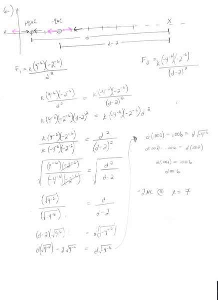

Where on the x-axis would the net force on a (-2) micro Coulomb charge be zero?
*picture attached*
F = k*(q1q2)/d^2
I think the answer is d= 6, making the position on the x-axis = 7. However, when solving my equation, I have to take the square root of a negative number, which obviously has no real answer. I couldn't seem to logic my way around it, so what am I missing? Other than expressing the answer in terms of i, how can I get around this??

9 μC = 9×10‒6 C , Similarly ‒4 μC = ‒4×10‒6 C and ‒2 μC = ‒2×10‒6 C.
You have written them as 9‒6 C, ‒4‒6 C, and ‒2‒6 C .
(Maybe you are simply using a non-standard notation.)
You need F1 + F2 = 0.
So that F1 = ‒ F2
That should take care of your signs.

Yeah, I just write it like that as a kind of short hand.
Anyways, I figured out what I was doing wrong. The equation should only be used to calculate the magnitude of the force, so I shouldn't put the negative in the equation for the -4 micro Coulomb charge. That takes care of it. Thanks for the reply though.
