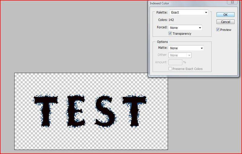

Similar to what Jonathan said earlier, in order to save your image with a transparent background you will have to save it in either GIF format, or TIFF format. GIF is usually the simpler solution though. Take a look at the thumbnail and you will see a shot from Photoshop CS3. You can also see from the additional "TEST" picture shown below with the desired transparency I think you are looking for.
First you will want to make sure you layer the background that you want to get rid of, and be sure it isn't locked. Then either delete it, or just hide it. Afterwards when you save as a GIF just be sure to check the transparency box.
I'm finding this difficult to explain. Let me know if I'm on the right track at all for explaining this, or if I'm clueless on what your looking for.
*EDIT* If you don't know how to layer the background, you'll want to choose your "Magic Wand Tool," and click somewhere on the white background. Once the squiggly lines have outlined the area you want, right click on the image and choose "Layer Via Cut." That will create a new layer for the entire background area around the logo. Then simply delete or hide the new layer you created. Also, be sure the background you are working on doesn't have the lock symbol next to it. If it does, then right click and choose "duplicate layer." Once you do that just delete the original locked layer. This will allow you to modify things.
