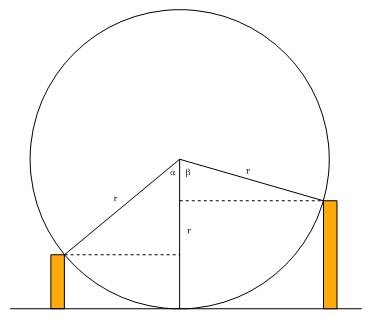

OK eveyone. Here's a picture drawn to scale:
Only two questions left:
1. Does everyone understand where the equations come from?
2. Were any of you able to solve the system with a calculator or computer?
Yes.. this is what I came up with... But like I said I don't know how to use my calc to solve for R...
This is my picture...
Then...
Segment DB = 1; Segment BO = R - 1
Segment DC = 2; Segment CO = R - 1
Thus Cos Alpha @ angle AOB is (R-1)/R
And Cos Beta is R-2/R
then from there is simple algebra...

I don't agree it is "simple algebra" from there. You need a nonlinear system solver to get a numerical answer. If your school has access to programs like Maple, Mathematica, or maybe Matlab, they can easily solve it numerically for you. I'm not familiar enough with the latest hand calculators to tell you whether or not your calculator has the capability to solve it. I'm guessing not.
Just for a checkpoint, you should get r = 2.768 approximately.

Sorry, I was meaning to say that it is simply algebra to arrive to r cos(α) + 1 = r;
r cos(β) + 2 = r; r(α +β) = 6...
But yes that is the answer in the back of my trig book... How did you get that?
And I have a TI-89 calc..
