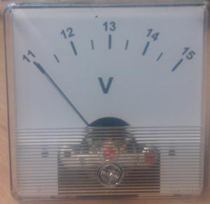

No our voltmeter is like a "clock", it isn't digital. You have three inputs. It kinda looks like this
Yeah, that's an analog voltmeter, and it probably has a pretty low input resistance (1MegOhm maybe? or lower?). No wonder the capacitor discharged relatively quickly.
But does that voltmeter have this thing called "MOSFET"? It doesn't feel natural to include the word "MOSFET" in my answer.
