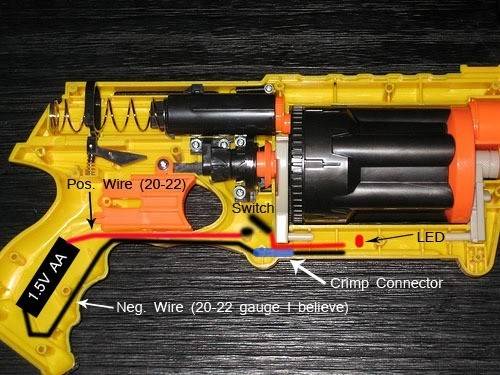

Alright, so. I had tried the electric tape method to tape the stripped ends of the wire to the terminals on the batteries. It kept falling off or coming loose. So, I just decided to run out to RadioShack and pick up a AA battery holder. Sadly, I found an enclosed 2 AA battery holder, however, the project I'm working with isn't going to fit if I use it. So, I picked up a 1 AA holder, and had to get a 1.8V LED, instead of my 3V that I was using for two. The LED I'm using now is a bit dim, however, it still lights up. Laugh if you may, but the project I've been trying to do is lighting up my Nerf Maverick. I thought'd it be not only fun, but a challenge. So I attached a very quick schematic I drew up on a picture of the innards of a Maverick. I'm thinking that after attempting to fit everything in there, I may as well just buy a project kit and mount it on there. Question is, would anyone happen to know how I could mount it on plastic without it becoming extremely bulky? Would this where the hot glue gun be of use?
Also, another quick question. I've seen that AA and AAA (and possibly a few others) have a voltage of 1.5V. MY question is, is why do they both have 1.5? I've seen a 6V and 9V battery, of course, but if I'm using 1 AA, why couldn't I use 1 AAA if they are the same voltage? Is it because of the amps? Was the AAA made for a smaller size convenience? Haha, sorry for the bombarding questions, this question has been pestering me for quite a while.

Yes it is for the Amps. AAA can source lesser amps than AA due to less size and higher internal resistance. Low power devices generally are smaller in size due to it's area of application.

Sorry to be so long in replying...
You could probably tape/glue this onto the outside (barrel or handle--if it works for regular ammunition / gun, it'll probably work for a NERF gun!) Applied judiciously, electrical tape sometimes works. Frequently, it doesn't (due to vibration / movement preventing good electrical contact). Sometimes, it works against it (due to the conductors being separated by a layer of adhesive). The battery holder? Wherever you can squeeze the weight in, and run wires from.
Why 1.5V in an alkaline cell? That's the potential in the particular chemistry of the cell you're using. 6V and 9V batteries use 4 or 6 cells in series. Note that NiCD and NIMH batteries (different chemistries) are slightly lower than these nominal alkaline voltages, usually around 1.2-1.3V / cell when fully charged
http://en.wikipedia.org/wiki/Alkaline_battery
AAA (and even AAAA--usually in hearing aid systems) were built for lower capacity, but smaller size, as you surmise. The downside is that (for a given brand and chemistry) they'll cost more per battery than AAs.
