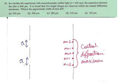

See figure attached for problem statement as well as my attempt
I don't know where to go from here. Can someone help me get started?

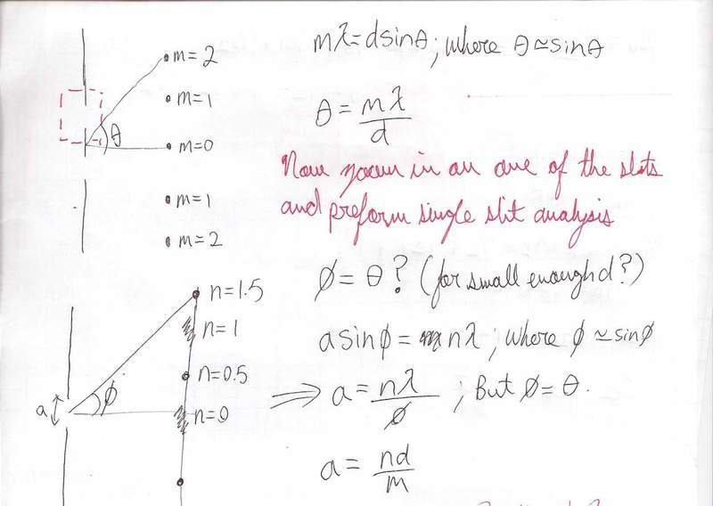

Here's my best attempt at reasoning things out.
I'm not getting the right answer, but it's a shot!

What have you learned about the diffraction pattern of multiple slits?
There are two patterns: one from the single-slit diffraction, the other from the interference between the rays traversing separate slits. The minima of the diffraction pattern are at sin(θ)=m λ/a where a is the slit width and m =±1, ±2,... You get the interference maxima from two slits d=340μm apart at sin(θ)=n λ/d.
The first minima in the diffraction patter are at the angles where sin(θ-1)=- λ/a and sin(θ1)= λ/a. The "distance" between the interference maxima are λ/d. You see five bright lines in the range of the first diffraction maximum. What can be the ratio between a and d?

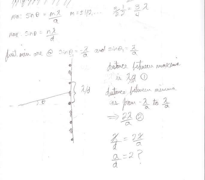

Here's my attempt at the ratio between a and d. See figure
Am I doing this correctly?

Read the text of the problem again. It is very difficult to read those very tiny letters but I see (with magnifying glass) something about five bright fringes. And sorry, I can not follow your handwriting. Please type in what you did.
