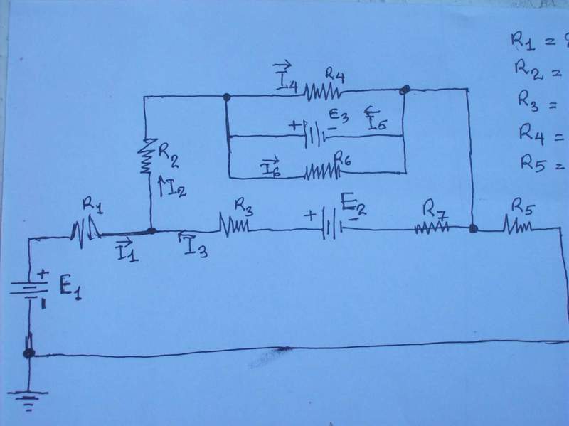

Measure the Voltage drop and current in all element of the circuit, given the figure which has the following Resistance and its Ideal emfs;
R1=20ohms, R2=70ohms, R3=55ohms, R4=45ohms, R5=30ohms, R6=20ohms, R7=70ohms, E1=15v, E2=5v, E3=5v.
please I need help as this is my first time coming across the Kirchoff law on a problem, i tried writing the follow after I read some books but it seems confusing if am correct thus i can't proceed further
I1+13=I2
I2+15=14+16
E3=I6R6+I5
E2=I3R3+I2R2+I4R4

immyrichie said:
I1+13=I2
I2+15=14+16
fine :smile:
E3=I6R6+I5
E2=I3R3+I2R2+I4R4
noooo :redface:
the first one should be just E3 = I6R6
you need the voltage drop across each component: since there's no component in the I5 section, it doesn't appear (and you're only allowed IR combinations anyway, not an I on its own :wink:)
in the second one, you've left out I3R7
(and of course there's two more KVL loops to do)
It might be worthwhile to consider given that the voltage sources are all ideal (no internal resistance), that E3 fixes the voltage across R4 and across R6. Thus via Ohm's law, the currents through both resistors are also fixed. This means that R4 and R6 are "solved" for their voltages and currents.
It also means that R4 and R6 play no further role in the circuits analysis and can be ignored (you can actually remove them from the circuit without affecting anything else). This is so because again, E3 is completely determining the voltage across the R4/R6/E3 combination, and thus only E3 will appear in any KVL equation that includes them as a "component". This leaves you with just two KVL loops to handle.
thanks so much for reply, since I'm now left with two loop I tried this out for the loops;
E2=I3R3+I2R2+I4R4+I3R7;
E1= I1R1-I2R2-I4R4-I3R5.
how well is this?

The first one looks OK.
The second one has errors.
The current through R5 is I1.
You have the wrong signs on I2R2 & I4R4 & what should be I1R5.​
Don't forget: As gneill pointed out, I4R4 = E3 = 5V.

just to add to what SammyS :smile: says …
you can take any loop, so the simplest ones would be the ones with the fewest Rs …
ie the loop containing E1 R2 E3 and R5, and the loop containing E2 R3 R2 E3 and R7 :wink:
hah, thanks so much guys. after these equation, what's next?
put all the E and R numbers in, and solve for all the Is
then the voltage drop across each component is IR :wink:
