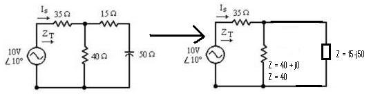

here is the circuit I am trying to figure out
I have to find the total impedance for the circuit.
I know how to find the total impedance in a series circuit and in a parallel circuit when I have just the Resistor and the capacitor. But I have no Idea how to figure this out. I been at it for 2 days and i can't seem to find anywhere on line or the book on how to do this.
I have tried to add up the resistors first in every form and then try to find the total Z = RXc/sqr(R+Xc), -Tan^-1(XC/R)
can someone point me in the right direction.

The numbers look good. Keep in mind that the sign for the imaginary component (reactive component, the one with the 'j') will be a + for inductors and - for capacitors, but when there is no reactive component then you can have +/- as j * 0 = 0.
You only add them together when they are in series! So the 15R resistor and 50R capacitor could add together to give you 15 + j0 + (0 - j50) = 15 - j50 as the equivalent impedance for that branch.
You could then redraw the circuit to look something like what I have attached. In this case you have two impedance's in parallel and you know how to handle that! (Keep in mind that j^2 = -1 also).
After that, you can redraw the circuit again and you will have one final resistance to combine into your impedance conglomerate.

ok so I got this far from reading some stuff in the web.
15-j50
35-j0
40-j0
now I have to find the Z in parallel 1/(1/z+1/z) now how do I do this with these numbers
ok so using this formula Ztot= Z1 Z2 / (Z1 + Z2 ) my answer was (600-j2000)/55-j50
am I way off ?
Treat them like normal algebra with 'j' as an unknown, except that j^2 = -1.
1 / ( 1/(15-j50) + 1/(40) ) = ...
As an alternative, first perhaps figure out algebraically what the parallel combination of two resistances A & B is using that formula. This is a shortcut that is quite useful to know and always works for any two resistance / impedance in parallel. Show your working though, just in case :smile:
*Edit: beat me to the punch, your answer is correct, but unsimplified! Z1*Z2 / (Z1 + Z2 ) is the easy shorthand method for 1/(1/z+1/z) that always works with two resistance / impedance in parallel.

ok finally I am getting somewhere so now with the Z= Z1+Z2 I got the answer of (2225-j3750)/55-j50
is this correct ?
Now do i just cover it into polar form and then just divide in polar form?
i
Z = Z1 + Z2 since the last two impedance's are in series, correct.
Z1 = 35 + j0
Z2 = (600 - j2000) / (55 - j50)
Could you write the maths you used to get (2225-j3750)/55-j50?
*Edit: Simple mistakes are easy, and if you don't show a bunch of working on these steps, people may mark you down in exams.

(600 - j2000)*********35
(55 - j50)************1
(600 - j2000)*****35(55 - j50)
(55 - j50)**********(55 - j50)
35 * 55 = 1925
35 * -j50 = -j1750
600 - j2000 + 1925 - j1750 = 2525 - j3750
-1 mark for simple math mistake, given you wrote down what you intended (showed workings), OR -2 marks for the wrong answer with no explanation as to how you got it (did not show workings).
Yes, now you have the number you can simplify.
This can be done by converting both to polar form and treating the Magnitudes like a normal fraction, and the Angles when divided will actually subtract e.g. [X / Y] / [A / B] = X/A / (Y - B) ... hopefully you can tell which '/' I mean as a division and which is the 'angle' signifier!
This can also be done by multiplying the top and bottom of the fraction by the complex conjugate of the denominator. e.g [X + jY] / [A + jB] * [A - jB] / [A - jB]. You will note that the second fraction [A - jB] / [A - jB] = 1, so this is a legal multiplication, and you may know that when any complex number (impedance) is multiplied by its complex conjugate (the same number but with the sign of the 'j' component changed) the result will be a real number, and the fraction will reduce to something along with the form of Z = X + jY.
If you're keen, do it both ways and you should get the same answer.

My comments above were in regards to 600 - j2000 + 35 (55 - j50) != 2225 - j3750 and how the expansion on the top line was incorrect (it should be 2525 - j3750). You still have the 55 - j50 on the bottom to contend with.
