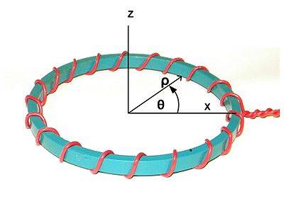

From Wikipedia:
Something like this.
Where is the Amperian loop in the picture?
Right...if you draw an amperian loop (a circle that is coaxial with the torus) that is smaller than the inner radius, you enclose no current, thus no B-field. If you draw it so the radius of the loop is between the inner and outer radii of the torus, you enclose N*I, and r*d(theta) (or your differential line element on the circumference of the amperian loop) is always parallel to the B-field (B (dot) dl = BL = B2*Pi*r. If you draw it larger than the outer radius, you enclose net 0 current, and have net 0 B-field.
A circle within the blue ring itself.
