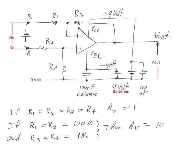

Im using the set up on this page http://www.electronics-tutorials.ws/opamp/opamp_5.html with all the resistors set = to each other. I have tried 100, 500, 1K 10K but i will always get a diference of 1.x v or 2.x v and if i check the voltages going into the v1 and v2 the difference is only 100mv. Could the problem be i am using a dc powersupply to test this circuit? or is there some other reason this circuit isn't working. I have tried several different opamps adjusting the input voltage to match the specifications but none seem to work.
Your post is rather vague.
What do you mean by "a difference of 1.x v or 2.x v and if i check the voltages going into the v1 and v2 the difference is only 100mv"?
If all of the resistors are equal to each other, then the differential gain will be approximately = 1 as stated in the document accessed by the link.
For example, if you connect a 1.5 Volt battery between the V1 & V2 inputs (+ to V2), then Vout should be approximately = 1.5 Volt. Or if you reverse it so the + is connected to V1, then Vout = -1.5 Volt approx.
What supply voltages have you connected to the supply pins? I have attached the data sheet of the LM358 as an example.
I suggest you use +5 Volt & -5 Volt ie. +5 Volt to Vcc (pin 8) & -5 Volt to Vee (pin 4).
You can use higher voltages if you wish. eg. +/- 15 Volt, it won't make any difference to the result - unless the amp is overloaded by too much input voltage.
There is no need to change the Op Amp, they should all work.
what I am saying is if i put 1.7 into v1 and 1.8 into v2 i get an output of one and some change or 2 and some change. not the .1V difference it should be. I can't figure out why it stops at some random voltage and won't find the difference of the input. I am aware the gain is 1, which is why the output doesn't make sense to me, and i don't know enough about voltage subtractors to know why it's doing that.
i'm also using a 9V battery as a source, so putting in a +- 5 volts isn't doable.
A picture is worth 1000 words. See attachment.
Use two 9 Volt batteries to give you a + 9V & a -9 V supply.
Note that you also need the 100 nF capacitors for stability.

What you actually need is gain, but you have an inconvenient DC bias voltage present.
If you use the circuit in post #2 above, you can get gain as well as get rid of the 4.5 volts of bias voltage.
In the following, you can see the effect of varying the non inverting input.
[PLAIN]http://dl.dropbox.com/u/4222062/Non%20inv%20amp%202.PNG
The output will be 4.5 volts for 4.5 volts in, but variations from this 4.5 volts input will be amplified by about 10, so that 4.6 volts in will give 5.5 volts out, giving a gain of 10.
The gain is set by the resistor values & there will be virtually no DC common mode voltage with the circuit I posted.
And the common mode rejection will be quite high provided that the resistors are matched, ie. R1 = R2 & R3 = R4.
Use 1% resistors or select on test from several.

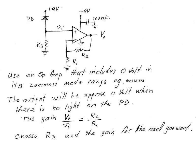

I just re-read what you want and I realized my previous suggestion was more complex than necessary.
My improved suggestion is attached.
This will give you flexibilty in choosing the output voltage & voltage range you want.

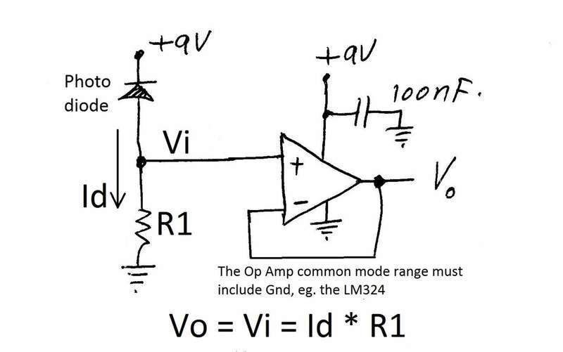

Here is an even simpler suggestion.
Select R1 to give you the output voltage you want.
Vo will be approximately 0 Volt when there is no light on the diode.
