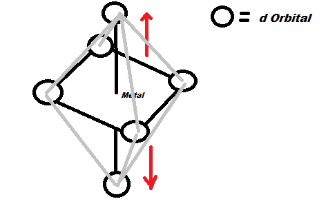

I've been told that the structure of Cu Nitrate is that of a octrahedral and appears similar to the picture attached. also that the distance at which the two vertical orbitals are away from each other varries the intensity of the blue colour, with the further the orbitals being away from each other the more intese the colour. I was just wondering why is this? and could someone please maybe further explain the images, i kind of know what they represnet but still don't fully understand them, for example are the orbitals pictured actually only the d orbitals and if so where are the others?

So this is completely wrong?
I was told that the extension of the vertical d orbitals of an octehidral structrure (at least for Cu Nitrate) intensifys the blue colour of the Cu Nitrate. I'm struggling to understand how this jump in electrons from lower energy d-orbitals to higher d-orbitals relates to the octehidral diagram. Does this distance represent the strength of the crystal field?

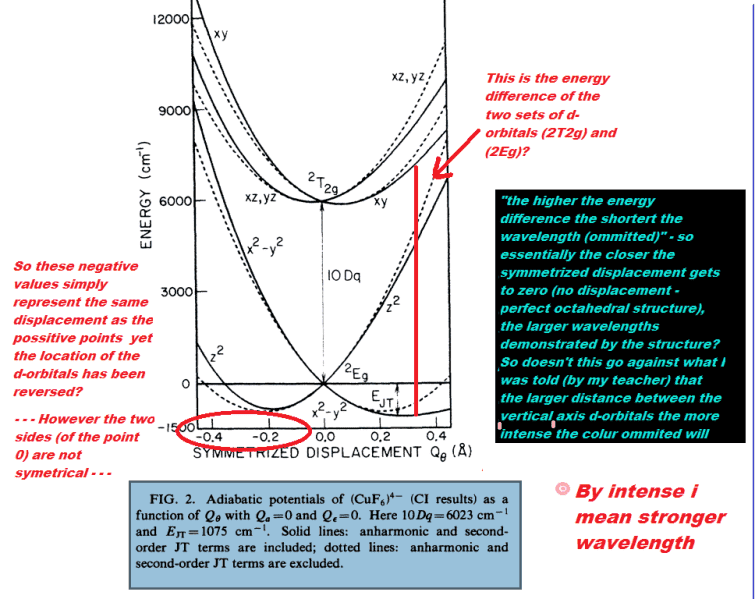

Please read the text on the attached picture.
So basically what i gathered from this diagram was that either I'm miss interpreting it (most likely) or my teacher's wrong. So are the statements i made correct?

No, negative values of Q_theta mean that the octahedron gets crushed while positive values signify increasing elongation (with a square planar coordination as the limit Q = infinity). I think that symmetrized displacement refers here to the fact that they assumed that at least the four fold symmetry of rotation around the elongation axis is retained (which is not exactly the case in the compound they are studying).
You are right that the energy difference you painted in read is the one which is responsible for the absorption in the red part of the copper spectrum (=blue colour of the solution). However, strictly speaking, the designation as E_g and T_2g only refer to the ideal octahedral complex.
The intensity of the colour perceived depends in the case of copper complexes critically on how near the center of the shortest wavelength transition (which is still in the infrared) is to the visible part of the spectrum so that at least some absorption takes place in the visible part of the spectrum due to the finite width of the absorption line.
Refering to the second picture, what must be meant is obviously the energetic distance of the d-orbitals not any spatial distance.
