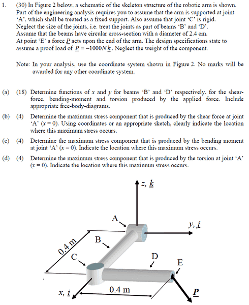

The discussion focuses on verifying the calculations for homework equations involving shear stress, bending stress, and torque in a mechanical engineering context. Key equations include shear stress τ = 4V/3A, bending stress σ_b = Mc/I, and torque τ = Tr/J. The user calculated maximum shear stress as 29.5 KPa and maximum bending stress as 294.7 KPa, both of which were confirmed as correct by other forum members. The calculations were performed using standard formulas for shear and bending in cylindrical structures.

[tex]\tau=\frac{4V}{3A}[/tex]
[tex]\sigma_b=\frac{-Mc}{I}[/tex]
[tex]\tau=\frac{Tr}{J}[/tex]
[tex]J=\frac{\pi r^4}{2}[/tex]
[tex]I=\frac{\pi r^4}{4}[/tex]
a)
[itex]-V(x) + R_y = 0[/itex]
[itex]V(x) = R_y[/itex]
[itex]V(x) = 1000[/itex]
[itex]M(x) = \int V(x)dx[/itex]
[itex]M(x) = 1000x[/itex]
[itex]T(x) = P(0.4)[/itex]
[itex]T(x) = 400[/itex]
[itex]V(x) - 1000 = 0[/itex]
[itex]T(x) = 0[/itex]
b)
[tex]\tau_{max} = \frac{4V}{3A}[/tex]
[tex]\tau_{max} = \frac{4*1000}{3*\pi*0.12^2}[/tex]
[tex]\tau_{max} = 29.5 KPa[/tex]
Coordinates: From (0,-0.12,0)m to (0,0.12,0)m
c)
[tex]\sigma_b=\frac{Mc}{I}[/tex]
[tex]\sigma_b=\frac{Mc}{\frac{\pi r^4}{4}}[/tex]
[tex]\sigma_b=\frac{1000*0.4*0.12}{\frac{\pi * 0.12^4}{4}}[/tex]
[tex]\sigma_b=294.7 KPa[/tex]
[tex]\sigma_{Max,tensile}=294.7 KPa[/tex] at (0,0,0.12)m
[tex]\sigma_{Max,compressive}=-294.7 KPa[/tex] at (0,0,-0.12)m
d)
[tex]\tau=\frac{Tr}{\frac{\pi r^4}{2}}[/tex]
[tex]\tau=\frac{1000*0.4*0.12}{\frac{\pi *0.12^4}{2}}[/tex]
[tex]\tau=147.4 KPa[/tex]
Is my work correct?
