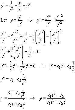

To solve a Riccati type diff eq a particular solution is needed
Not necessarily.
Often it is easier to transform the Riccati ODE into a second order linear ODE which can be solved without knowing a particular solution.

Thank you for your answer Jacquelin. I still have some questions.
-We have two constants in the solution to a first order equation because of the intermediate second order diff eq. But the original eq is a first order one. Then how could the second constant be determined in a boundary value problem? Or one of them is zero automatically?
-It seems that we still cannot have the particular solution y1=-1/t according to new solution. Does it mean it is a singular solution?
-How did you solve the intermediate second order diff eq with variable coefficients without series expansion?
In fact there is only one constant in the solution (due to the proportional relationship y=f'/f )
Let c=c1/c2 and rewrite the general solution as :
y = (c t²-1)/(t(c t²+1))
No, we can have the solution y1=-1/t . It corresponds to the case of c=0.
The intermediate linear second order ODE f''+(1/t)f'-(1/t²)f=0 is homogeneous. So, referring to the usual method, the characteristic equation corresponding to solutions of the form t^k is :
k(k-1)+k-1=0 which roots are k=1 and k=-1 so, the solution of the ODE is :
f = c1 t + c2 / t
