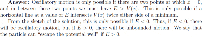

my professor said if it doesn't intersect V(x) twice then it does not osccilate
Try writing what your professor said without using "it".
when you say without using "it", i am assuming that you thought i knew the answer and you are referring to "it" as the solution?
the attachment that i added was the solution to another question, not this one (it explains that it needs to intersect twice for oscillation, but i don't know how to use that fact). anyway back to my question.

This is the graph of V(x), not v. V is the potential energy at a distance x. I'm asking you about v, which is velocity. I've been very careful to note that v means x'.
If V = 0, a horizontal line won't cut the graph at all. If V >= .15, a horizontal line cuts the graph only once.
I'm getting somewhat discouraged, since you seem to have such a hard time taking even the smallest steps on your own. It might help if you went back through this whole thread and reread it carefully. If you have a specific question about anything that has already appeared, ask it.
Mark44 said:
Did you graph y = x^3 - 8x^2 + 16x - 8?
What you have found are the three x-intercepts of this function. At each of these three values, x' = 0, which means that V = E0. At all other positions x, the value of x^3 - 8x^2 + 16x - 8 is either positive or negative. Tie this information into your equations for T and V and see what that says about the particle's motion.
Mark44 said:
I don't understand why you're doing this. At the three roots, T = 0 because x' = 0, and these three values of x are the ones for which V = E0 = .125.
If I'm remembering my physics, the equation T + V = E0 is saying that kinetic energy (T) + potential energy (V) is constant (E0).
At the x values x = 2, x = 3 +/- sqrt(5), x' = 0. At all other positions (values of x), x' is NOT zero, which means that the velocity must be either positive (particle moving to the right on the x-axis) or negative (particle moving to the left on the x-axis).
Mark44 said:
Your energy equation works out to
(1/2)mv2 + 1/x - 2/x2 + 1/x3 = 1/8, with v = x'
Solving for v2, we get
v2 = -2/m(1/x - 2/x2 + 1/x3 + 1/8)
When v = 0, you have -2/m(1/x - 2/x2 + 1/x3 + 1/8) = 0, and you have already found the x values for which v = 0 (x = 2, x = 3 +/- sqrt(5)).
Now v2 is necessarily >= 0, so 1/x - 2/x2 + 1/x3 + 1/8 must be <= 0, since it's being multiplied by -2/m, a negative constant.
For what intervals is the graph of y = 1/x - 2/x2 + 1/x3 + 1/8 strictly negative? It has to be one or more of these intervals: (-inf, 3 - sqrt(5)), (3 - sqrt(5), 2), (2, 3 + sqrt(5)), or ( 3 + sqrt(5), inf).
ok you said at the oscillating points x'=0, so we would only have the potential part V when it oscillates.
now i have to assume that x' is not 0, to get my answers, so let x'=v
http://www.wolframalpha.com/input/?i=v2+=+-2/1(1/x+-+2/x2+++1/x3+++1/8),++x=1
What happens to x' (= v) when x is between 3 - sqrt(5) and 2?
x'=v is an imaginary number?
example when x=0.83
http://www.wolframalpha.com/input/?i=v2+=+-2/1(1/x+-+2/x2+++1/x3+++1/8),++x=3+-+sqrt(5)+0.1
we get v= +/- 0.5i, if we assume x=1, which is also between that interval
This graph is not very useful, as it has x on the vertical axis and v on the horizontal axis. A more useful graph would be y = -2/1 (1/x - 2/x2 + 1/x3). What you're looking for are the x intervals for which y > 0.
How does this make any sense at all? v is the velocity of a physical particle. Is it meaningful to look at imaginary or complex values of velocity?
cloud360 said:
example when x=0.83
this part (1/x - 2/x2 + 1/x3) represents V, and i can see from this graph
http://www.wolframalpha.com/input/?i=Plot%5Bx^%28-3%29+-+2%2Fx^2+%2B+x^%28-1%29%2C+{x%2C+0%2C+8}%5D
which u said is not that helpful, i can see when V>0.15, there is no osccilation
So is we say 0.15=(1/x - 2/x2 + 1/x3)
then -2*0.15=-0.3 = v^2
does this mean the minimum initial velocity is +/- sqrt3
