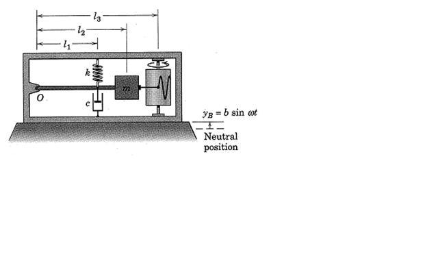

The figure attached shows the meter used to study the motion yB = bsinωt.
The motion of the mass relative to the frame is recorded on the drum.
If l1= 360 mm, l2= 480 mm, l3= 600 mm, m = 0.9 kg, c = 1.4 Ns/m and
ω = 10 rad/s, Determine the range of the spring constant k over which the magnitude of the recorded relative displacement is less than 1.5b. It is assumed that the ratio ω/ωn must remain greater than unity
mx'' +cx' + kx = 0
w = sqrt(k/m)
-m(w^2)bsinwt + cwbcoswt + kbsinwt = 0
cb(k/m)coswt = 0
This is what I've done so far, I am quite lost on this question am I at all on the right track?
1.5b
What is b ?
ω = 10 rad/s,
What is ω ? Where is it applied ?

b is the amplitude of the oscillation and [tex]\omega[/tex] is the angular velocity. what do you mean by where is it applied?
[tex]\omega[/tex] is the angular velocity of the rotating drum (see attached image above)
Naa, honestly I think the drum is just the equivalent of a modern oscilloscope. No one cares about the drum.
It could well be that ω is the angular velocity of the metal rod, which moves of small angles, but has a ω.
More simply, I think ω is the pulsation of the spring-mass system.
More mysterious is b. If I displace the mass m an then let it free to move, that displacement will be the biggest that will be recorded, because the system will generate a damped series of oscillation with decreasing amplitude.
So, what does it mean to keep the amplitude less than 1.5b ?Ah ok, wait a minute, what is the meaning of the Yb = bsin wt in the right bottom corner ?
It means that the whole system , the box is "shaken" with a movement like b sin wt.
Ok, now things make sense. So you got a forced oscillator, with a sinusoidal force.
You can look here:
http://en.wikipedia.org/wiki/Harmonic_oscillator
section Sinusoidal driving force

Thanks for your reply.
I have a fair understanding of it, but still quite confused on how to do this problem and where all the different equations are coming from.
Do I find the steady-state solution and use that to find k?
