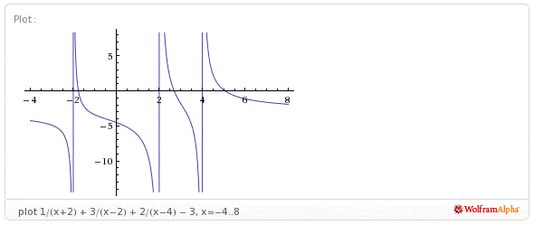

Also, graph some simpler but similar function like g(x)=1/(x+2)+3/(x-2)+2/(x_4) - 3 .

Abdul Quadeer said:
1) No real root
2) At most one real root
3) No complex root
4) At most two complex roots
This is an interesting question since it doesn't offer "5) None of the above". How do your materials define a "complex root". After all, real numbers are a subset of the complex numbers. And are we assuming all the constants in the equation are real numbers?
The problem only makes sense if you assume all of the constants are real. If you do then it makes good sense. The numerators are squared to ensure they are positive. Use Abdul Quadeer's observation that the function is always decreasing and sketch the asympotes. Use the graph to count the real roots for various cases of k. There really is a good answer. At least if you ignore some stupid phrasing problems in the A, B, C, D selections and just try to figure out what they want you to conclude.

To summarize the advice so far, visualize adding the fractions together with a common denominator that is the product of the denominators. You get a numerator that is a polynomial of a certain degree. The function's zeroes are the zeroes of that polynomial. You can count the real zeroes of the function by imagining the graph of the original function. See if that accounts for all the zeroes of the function. Any not accounted for, must be complex.

Sure, or you can see it from your asymptotes. If you clear the fractions to get a polynomial to solve and n is the number of terms, the polynomial has degree n if k is not zero and degree n-1 if k is zero. Now if you count the intersections of the graph with the line y=k you get n intersections if k is not zero and n-1 if k is zero. So the number of real roots is equal to the degree of the polynomial and there are no complex roots.
