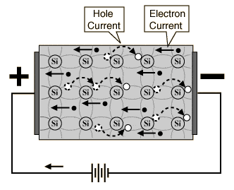

Hi all. I understand that a hole is the absence of an electron. I have come across textbooks with instances where they talk about movement of minority carriers, and movement of majority carriers. Since the hole has to be one of them, they are referring to moving holes.
But, how can a hole move? I can understand movement of an electron just fine.

Imagine you have a hole with electrons around it, then one electron moves into that hole which in turn creates a new hole where that electron was, hence the hole moves :)

I can't totally buy this. There is no guarantee that because an electron filled a hole, there must have been a hole created somewhere else. Maybe it was an extra electron to begin with?
By this definition, holes don't really move at all. They just disappear and reappear in different places.

In some sense you are right. There *is* no guarantee. Sometimes the holes are filled by free electron and sometimes free electrons fall into what are called "traps" which are holes or allowable energy states. This can be troublesome in certain devices. Generally, though, the effect of this is minor and holes act just like a positive electron (except with lower mobility to account for the jumping in and out of valence shells). The effect is minor because the "extra electrons" due to dopants is TINY compared to the number of lattice sites in a semiconductor. So, what you said is totally possible, but it just doesn't happen all that often.

The term "virtual particle" has a technical definition in physics and a hole does not qualify. A hole is absolutely a particle in the same way as an electron as far as . If you look at traffic from an airplane you see holes propagating down the freeway as people speed up and then are forced to slow down. Try looking some time.
And the release of a photon (or a phonon) when holes and electrons recombine isn't anything "more than meets the eye". It can be explained using the Bohr model of the atom. An electron falling into a bound state must release energy because its momentum is changing.
In semiconductors, electrons and holes move with a velocity proportional to the electric field.
v = μE
where μ is the mobility (cm2/Volt-sec) and E is the electric field (volts/cm)
Typical electron mobility μ for Si at room temperature (300 K) is 1400 cm2/ (V·s), and the hole mobility is around 450 cm2/ (V·s).

I agree, the analogy does not hold up... that is why it is an analogy and not an explanation. Of course a hole cannot exist without an electron, but as a charge carrier in a semiconductor it can act as if it were independent. The reason is there is a practically infinite (as far as our purposes usually go) number of electrons, so we can have many holes doing their thing. Minority carrier devices such as BJTs *depend* on holes acting as a particle. Certain classes of image senors collect holes, not electrons. They exist as a particle as much as an electron does, since an electron is *merely* a probabilistically located packet of charge that exhibits wave and particle-like qualities.
I guess my point is that it is useful to think of them as particles. Thinking of electrons as particles is also a useful analogy, but not one that is fundamentally more correct, in my opinion.
As for the *more than meets the eye* thing, I wasn't trying to be rude. I have studied enough over the years that this electron/hole behavior has become somewhat intuitive to me.
The "hole" in semiconductors is analogous to a bubble in water or carbonated drink. The bubble is a void, has no mass, moves only under the influence of the gravitational force (analogous to the electric field), but moves in the opposite direction to (is "repulsed" by) the normal gravitational force. So without water, the bubble does not move. The water is equivalent to a sea of electrons, and the bubble a void in the sea. Gravity is equivalent to the electric field that attracts water and repels voids.

In an intrinsic semiconductor like silicon at temperatures above absolute zero, there will be some electrons which are excited across the band gap into the conduction band and which can produce current. When the electron in pure silicon crosses the gap, it leaves behind an electron vacancy or "hole" in the regular silicon lattice. Under the influence of an external voltage, both the electron and the hole can move across the material. In an n-type semiconductor, the dopant contributes extra electrons, dramatically increasing the conductivity. In a p-type semiconductor, the dopant produces extra vacancies or holes, which likewise increase the conductivity. It is however the behavior of the p-n junction which is the key to the enormous variety of solid-state electronic devices.
