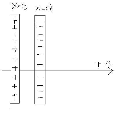

Two thin long charged metal plates are placed at x = 0, and x = d (that means they are plaed vertically, parallel to the Y Axis. Thus the distance between them is d. Assume that V(x=0) = 0, and that the thickness of the plates is lesser than d.
a) Find E(x) and V(x) when 0 < x < d.
First of all let the surface charge density [tex]\sigma = \frac{Q}{A}[/tex]
If i use Gauss Law then the Electric field [tex]E = \frac{\sigma}{\epsilon_{0}}[/tex] since the plates are conducting surfaces.
To find [tex]V(x) = \int E \cdot dx = \frac{\sigma}{\epsilon_{0}} \cdot dx = \frac{\sigma}{\epsilon_{0}} x[/tex]
i'm not really sure if i derived that expression correctly for V(x) which i why i need your help, please.
b) Find E(x) and V(x) if x > d
E(x>d) = zero or kq / (x+d)^2
V(x>d) = zero as well? or simply integrate E over x??
c) Find E(x) and V(x) if x<d
same as the previous one?? i.e. both E and V are zero?? Not really sure here either?
d) Sketch E(x) and V(X)
I m not really sure about my expressions in a so if i found those out properly, with your help i can easily do this one!
Thank you in advance for your help!
so is ther anyone out there who can help me!
i am cofnused about hte first part whether E = kq/r^2 or E = constnat
but then the graphing part would be useless no?
And wha about the outsides of the plates?
Your E field and potential for the middle region (0 < x < d) are correct!
For x > d the electric field will be zero (it's discontinous due to the charge) and likewise for x < 0. However, the potential will be continuous across those surface.
