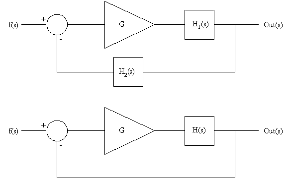

Reading my text I see the definition of open loop transfer function as GH and closed loop as G/1+GH
I cannot understand the def. of open loop t/r func. Shouldn't it be just G?
(B/w with open loop I understand that there is no feedback...)
Yes, I think typically G would be called the open loop transfer function.
The open loop transfer function may have gain G as well as some 'filtering' embodied in H.
A closed loop system can have 'filtering' elements in both the forward path and the feedback path. When such a system is simplified mathematically the entire thing can be rendered into the 'canonical' form G/(1 + GH), where H subsumes all of the disparate filtering elements that may be involved.

The actual implementation of a control loop may have a filter in the forward path and another in the feedback path. For purposes of analysis the two can be combined mathematically to create a single overall filter block (see attached).
The open loop response is handy because it's a simple form that permits you to completely characterize the transfer function and its response to various inputs (impulse, step, etc.), and the closed loop response is easily obtained from it mathematically. Consider it an analysis "convention".
Regarding stability, while it is true that an open loop configuration is not subject to oscillation or "hunting" (where the output ends up continuously seeking to match its goal and
'missing' due to either measurement errors or overzealous adjustment stepsize), the accuracy of the output response is entirely dependent on having the gain set exactly right for the desired response to the input. This is difficult to achieve and can require frequent calibration to compensate for component value drift, operating conditions, etc.
A properly designed control loop with feedback is inherently more accurate and stable, and is not nearly so sensitive to component aging and operating conditions. If the design places the poles inadvisedly, well, it's just asking for trouble! :smile:
