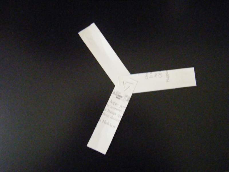

i need to find the moment of inertia for a cardboard boomerang. what equation could i use?
If it's so weirdly shaped that you can't model it with a mathematical function, you're out of luck. You'll have to use numerical integration to find the moment of inertia.
Moment of inertia about what axis? Have you considered an experimental approach? You might find its center of gravity by suspending it from two separate points and see where the vertical plumb lines intersect. You could suspend it from a point as a physical pendulum and time its period,...
its just 3 rectangular pieces of cardboard pieced together at one end of each piece to make a flat boomerang. each blade of the boomerang is 120 degrees apart.
the axis of rotation is through the center of the boomerang

Can you provide an image of the boomerang you have in mind so that we might be better able to advise on methodology? Approximate physical dimensions would also be a help.
each blade is approximately 5 inches by 1.25 inches. and it is made from a christmas card.
Judging by the symmetry of the figure, if the blades really are rectangular then you're in luck. You can work out the moment of inertia of a single blade about the center of rotation (which should coincide with the center of mass of the whole assembly) and multiply by three. Look up the expression for the moment of inertia of a thin rectangular plate about its center. Determine how far your center of mass of the "plate" is from the center of rotation and apply the parallel axis theorem.

No. Look up the Parallel Axis Theorem as I suggested. You need to be precise about where the center of rotation is with respect to the center of the plate -- in your case it won't be precisely at the end of the plate, but a bit in from the end. Measure and be sure.
the center of rotation is about 1 cm from the center of the plate. i looked at the wikipedia page for the parallel axis theorem and it was really confusing. I've only taken ap calculus ab.
That seems rather close to the center of mass of the plate. From your image it looked like it was more like 1cm from one end (the end where the blades all come together in the center), so about 5.4cm from the center of mass of the plate.
The parallel axis theorem states, in essence, that given a known moment of inertia I about some axis, then if you move the axis of rotation some distance r from that axis, being sure that the new axis is parallel to the old axis, then the moment of inertia about that new axis is given by Inew = I + M*r2. M is the mass of the object.
The formula that you found for the moment of inertia for the plate about its center should be 'shifted' by adding M*r2 to it, where r is the distance from the center of the plate to the actual axis of rotation.
thank you. I understand it so much better now. And you were right, it is about 5.4 cm between the center of rotation and the center of the plate. I simply misread what you wrote.
