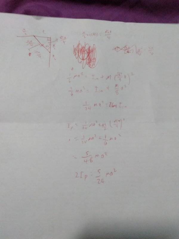

I did the working but my answer isn't correct
Working:
Where I_p is the moment of inertia about the center of the square
That picture is not of great quality. But I shall try to make sense of it.
You start with $$\frac{1}{6}Ma^2 = I_{\text{cm}}+M(\frac{\sqrt{2}}{4}a)^2$$ But that equation is already wrong. You are only dealing with ##\frac{M}{2}##, not ##M##.
Likes Eggue

Haha sorry about the image quality. You're right, once i correct the error i get the correct answer. One more question though, Why does the center of mass of the 2 rods lie on the line connecting the center of mass of each rod? Shouldn't it lie halfway between both rods which would give a distance of √(a2)2+(a2)2=√2a2(a2)2+(a2)2=2a2
