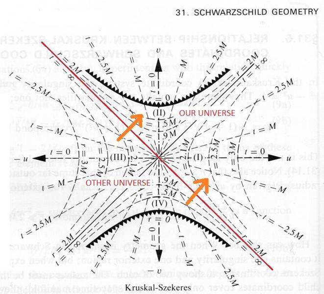

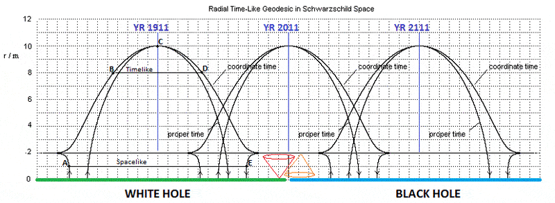

Below the event horizon, spacelike becomes timelike and vice versa. In the diagram below, events B and D (or B-C or C-D) are timelike separated and events A and E are spacelike separated. Agree?
Of course this leaves a problem because Wikipedia http://en.wikipedia.org/wiki/Spacetime states
For a particle traveling through space at less than the speed of light, any two events which occur to or by the particle must be separated by a time-like interval.
and we have a contradiction here. This implies that the particle rising out of the white hole is not the same as the particle entering the black hole, which seems reasonable, but there is the siren call of the particle's proper time progressing smoothly and continuously along the entire path. Lesson is, proper time progressing smoothly and continuously is not proof in itself of anything.
PeterDonis said:
If you draw the trajectories you are talking about on the maximally extended conformal diagram, you will see that the horizon the object passes on its outgoing leg is *not* the same as the horizon it passes on its ingoing leg. The first horizon goes up and to the left at 45 degrees; the second goes up and to the right at 45 degrees.
That does not prove anything. The first horizon has coordinates r= 2m and t= -infinity and the second horizon has coordinates r= 2m and t= +infinity. They only differ in time, but not place. Of course that depends on how you interpret time and space. Above and below the event horizon timelike and spacelike swap roles, but happens exactly at the event horizon? Undefined I guess?

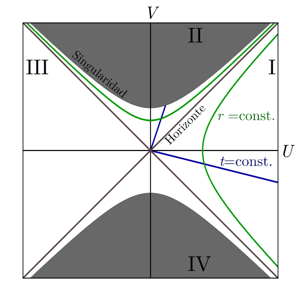

Also consider this KS chart:
The green r=constant line goes first up and to the left and then curves up and two the right, just like the two event horizons you mentioned so while its direction and time coordinate is changing, its spatial location does not. The two event horizons you mentioned are just an extreme version of the green r= constant curve.

In the first chart at the top of this post, I have added the "break" between the two singularities that you desire. It does not fix anything. For example I have placed the break at "now" (Year 2011). Now consider the particle that has its apogee (event C) at year 1911. It rises and falls back into the white hole contradicting the fact that particles are only supposed to exit from white holes. Other trajectories have particles rising out of the black hole contradicting the fact that particles can only enter but not leave a black hole. The only way to cure these contradictions is to insist that all particles have their apogees at year 2011, but of course we know from experience that that is not realistic.

yuiop, I should have been a bit clearer about one point in my previous response: your diagrams are *not* coordinate charts, and you simply can't use them to reason about how events are related the way you can with (properly drawn) coordinate charts. In particular, your diagram does not properly represent the causal structure of the spacetime (which events are timelike/spacelike related).
No, I do not. Both pairs are timelike separated. As you quoted from the Wikipedia page, both pairs of events lie on the same worldline, which is the worldline of a timelike object. Any pair of events lying on the worldline of the same timelike object must be timelike separated.
What is going on here is, as I said in my previous post, there are two *separate* regions in the spacetime which have r < 2M (i.e., two separate "interior" regions inside the horizon). Event A is in the first region, and event E is in the second. Thus, they are timelike separated even though they have the same r coordinates. If they were both in the same interior region, then you would be correct that they would have to be spacelike separated (since r is a timelike coordinate inside the horizon). But they're not.
The reason your diagram has difficulty representing this is that, as I said above, your diagram is not a proper coordinate chart, and it does not properly represent the causal structure of the spacetime. If you want to see how things are actually working, try drawing the "Year 2011" worldline represented in your top diagram on the Kruskal chart (I pick that one because your diagram shows that one emerging from the white hole and going back into the black hole, which is correct). You will see that the analogue of event A on that worldline is in region IV while the analogue of event E is in region II. You will also note that there are two "copies" of each r = constant curve; for r < 2M, one copy is in region IV and the other is in region II. So two events can both have the same r coordinate < 2M but lie on different r = constant curves, in different regions.
Now try drawing the 1911 and 2111 curves, also, on the Kruskal chart. You will see that there is *no* way to have a curve both emerge from and go back into the *same* "hole" (white or black). All three curves *have* to emerge from the white hole and go back into the black hole. So they all work the same as the 2011 curve did above. That's how A and E can be timelike separated.

It is not my diagram, it is a diagram by Prof Brown on his mathpages website. See http://www.mathpages.com/rr/s6-04/6-04.htm
His diagram is consistent with the standard Schwarzschild coordinate chart. Also see this diagram from MTW:
which is also the standard Schwarzschild coordinate chart. All I have done is added some sketch notes to the standard diagrams.

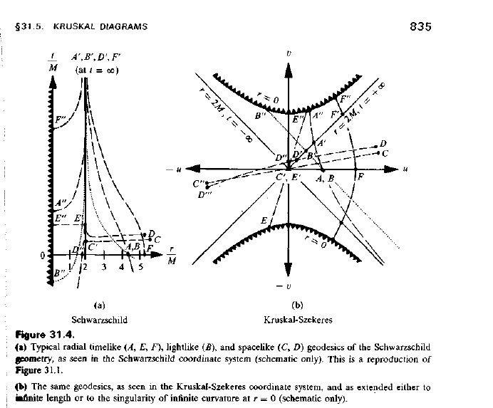

The Kruskal-Szekeres chart is derived from Schwarzschild cordinates by substituting new coordinates into the the Schwarzschild metric. If the Schwarzschild solution is wrong then so is the KS solution. Also, any valid coordinate transformation should have a one to one relationship between events in the two coordinate systems. Any unique event on a coordinate system should have one and only one corresponding event on the transformed system. KS coordinates introduce a whole new parallel universe that was not there in the original Schwarzschild coordinates.
"Consistent" in the sense that it shows curves which have relationships between coordinate/proper time and radius that are allowed by the Schwarzschild coordinate chart, yes (but with a caveat I'll get to in a moment). But that does not mean that his diagram is itself a proper coordinate chart. It isn't, and it isn't meant to be.
The caveat is that the "Schwarzschild coordinate chart" is not really a single chart. There are actually three of them. The first is the "Schwarzschild exterior chart" (I don't know if my terms are exactly the "standard" ones, but I'll try to make clear what I mean by them). It covers the region r > 2M ("region I" in the Kruskal chart). The second is what is normally referred to (more or less--again I don't know if my terms are exactly the "standard" ones) as the "Schwarzschild interior chart", which covers the region r < 2M that can be reached by freely falling through the horizon from the exterior region ("region II" in the Kruskal chart, the "black hole" region). The third could also be called a "Schwarzschild interior chart", but it covers the region r < 2M from which outgoing freely falling observers can cross into the exterior region ("region IV" in the Kruskal chart, the "white hole" region). I don't know that I've seen this third chart discussed explicitly, but it should be obvious that it is a valid chart and that it is distinct from the other two. (If any experts on the forum want to weigh in on this, please do.)
So when you say that the diagram is "consistent with the Schwarzschild coordinate chart", that's only true if you put a "break" in the region r < 2M, as I said before, to reflect the fact that that region of the diagram is really two separate, distinct regions that do not "touch" or overlap; or, equivalently, that region does not represent a single Schwarzschild interior chart, but two disjoint ones, so the disjointness needs to be included on the diagram to make it fully consistent. And, of course, when you do that the issues you're raising go away, because it's clear that the "outgoing" and "ingoing" portions of the worldlines pass through two separate interior regions.
You'll note, by the way, that Prof. Brown's page, which you linked to, discusses the two interior regions in the paragraphs after the diagram you refer to appears. What I'm saying is consistent with what he says. The only possible curve ball he throws is this statement:
Hence if we observe objects falling into the inner region, and other object emerging from the inner region, we seem forced to conclude that there are two physically distinct inner regions, or else that there exist closed spacetime loops if we insist on a single interior region.
I haven't checked his later discussion of black holes and cosmology to see whether he talks about closed timelike curves (which is what I think he means by "closed spacetime loops"), but I believe it's been shown that there are no CTCs in Schwarzschild spacetime.
You'll note that the text accompanying this diagram, and the correspondence between parts (a) and (b), makes it clear that in the (a) diagram, the interior region r < 2M corresponds to region II on the Kruskal chart, and that region only. It does *not* correspond to region IV. In other words, in the (a) diagram in MTW, the interior region is the "black hole" region, and that region only. If you tried to draw the entire worldline represented on Prof. Brown's diagram in part (a) of the MTW diagram, you would not be able to do it; the "outgoing" portion coming from the white hole can't be put anywhere on part (a) of the MTW diagram.
I didn't say the Schwarzschild solution was "wrong". As I clarified above, the Schwarszschild "solution" or "chart" is not a single chart, and none of the three charts that can be called a "Schwarzschild chart" covers the entire spacetime. The Kruskal chart *does* cover the entire spacetime, and makes clear the relationship between the different Schwarzschild charts. It's all consistent.
This is true, and it holds for each individual Schwarzschild chart. I made clear which region of the Kruskal chart each Schwarzschild chart covers above. Within each of those regions, there is indeed a one-to-one relationship as you describe. The *appearance* of a two-to-one relationship is only because you are not recognizing that region II and region IV are two separate regions, each with its own Schwarzschild chart.
If you mean region III, you are correct. That region would actually require a *fourth* Schwarzschild chart (a second "exterior" chart). Mathematically, I believe this region has to be there to make the full analytic extension work right (but my math-fu is not good enough to give a proof of this; maybe one of the experts on the forum can give more detail about how this works). Physically, as far as I know, neither that region nor region IV is present in an spacetime that anyone believes is applicable to the real universe; in the spacetime of a black hole formed from a collapsing star, for instance, only region I and region II are present (plus a non-vacuum portion representing the collapsing matter). For regions III and IV to actually be there physically, the entire spacetime would have to be a vacuum spacetime (i.e., no actual matter present anywhere) but still somehow have a black hole (and white hole) present. As far as I know, nobody believes this is actually physically possible; there *has* to be some matter somewhere for a black hole to form, and once you have a non-vacuum region, you have the spacetime I just referred to, where the only vacuum regions are regions I and II. So in any actual physical spacetime, there would be no "parallel universe" and no "white hole".
yuiop said:
The Schwarzschild coordinate system is two dimensional. One is space (the radial x coordinate) and the other is time.
Actually, the full coordinate system also has two angular coordinates, theta and phi. Those are often left out because the spacetime is spherically symmetric, so nothing of physical interest depends on those coordinates. Their presence does not affect the issues we've been discussing, because there are certainly such things as radial geodesics that have constant values of the angular coordinates for their entire length; basically we've just been restricting attention to those.
yuiop said:
There is no y or z coordinate, so saying two events with the same r coordinate are in two different places does not make a lot sense on a one dimensional radial line, unless we invoke the parallel universe of course, which is what K-S have done.
As I noted above, mathematically, regions III and IV are there in the maximal analytic extension, and are separate from regions I and II. But in any actual physical spacetime, they would not be there, because physically it's not reasonable to have a curved spacetime with no matter present anywhere (as I noted above). So in an actual physical spacetime, you are correct; there is only one interior region, so any value of the r coordinate corresponds to only one "place". But also, of course, in this case there is no "white hole", so there are no freely falling worldlines that pass through the same value of r twice.
Well I am glad you think that regions III and IV are unphysical, but that means we have no need for "maximally extended spacetime".
Another problem with the maximal KS chart is illustrated below (in your favourite chart):
Mass or light from the white hole (region IV) can move freely into our universe and mass and light from the other universe (region III) can also move freely into the black hole (region II) in our universe. Matter or light cannot pass from our universe to any part of the "other universe" so over time, if any mass is in the other universe it will end up in our universe and gradually our universe will be inexplicably increasing in mass and energy. Has anyone detected that?

That seems reasonable, but if you carefully plot worldlines in regions I,II, III, and IV on a KS chart, it does not actually achieve those objectives.
You'll need to post specific counterexamples if you want to convince me of this. MTW, for one, plot a number of worldlines on KS charts, and all of them meet the objectives.
Here are some sample geodesics (some timelike, some spacelike, some null) in the schwarzschild space-time on both the schw and KS charts from MTW. They are continuous and smooth on the KS chart,and a real mess on the Schwarzschild chart.

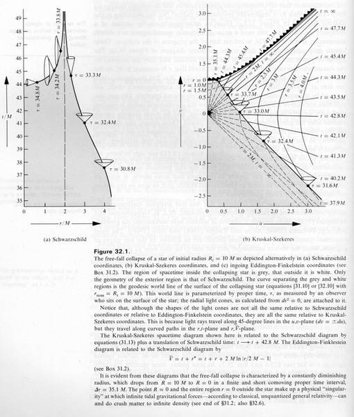

Not quite. The "physical" black hole spacetime I described earlier, which includes the collapsing matter that forms the hole, contains both an exterior vacuum region (corresponding to region I in the Kruskal diagram) and an interior vacuum region (corresponding to region II in the Kruskal diagram), plus the non-vacuum region that contains the collapsing matter.
Dscriptions are nice, but what is the metric of that "physical" spacetime?
I think the term "geometry" would be better than the term "metric", because "geometry" makes clear that what we are talking about is the underlying, invariant spacetime, not any particular expression of its metric in particular coordinates.
The geometry of the vacuum regions (exterior and interior) is the Schwarzschild geometry. The geometry of the non-vacuum region containing the collapsing matter is a contracting FRW geometry (the time-reverse of the expanding FRW geometry that is used in cosmology--more precisely, the k = 1, "closed universe" case of that geometry). The two geometries are "matched" at the boundary of the non-vacuum region, meaning (I think this is right) that the curvature and its spacetime derivatives need to approach the same values as you approach the boundary from either "side" (the vacuum or the non-vacuum side). This is for the idealized, precisely spherically symmetric case.
For a non-idealized case, the "BKL singularity" referred to in pervect's post is, I believe, a vacuum geometry, which more or less looks like the spherically symmetric Schwarzschild geometry far away from the singularity (so probably the exterior region, at least, would still be approximately Schwarzschild, at least provided the black hole wasn't rotating appreciably), but has chaotic curvature fluctuations as you get close to r = 0. I'm not sure exactly what non-vacuum geometry would "match" to that to describe the collapsing matter; again, while the matter is still far away from r = 0 (i.e., in the early stages of the collapse), I think it would still be close to the FRW geometry (with small perturbations), but it would have to also have chaotic fluctuations in the late stages of the collapse, and I'm not sure that such a non-vacuum geometry has a name (unless the "BKL singularity" solutions are supposed to cover thise case too).
