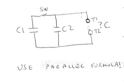

Hello lorenzforce, welcome to Physics Forums.
The old question if you connect only one thing across something else is it parallel or series?
The easiest way is to perform the test in my attachment.
I have drawn two capacitors and your switch (closed).
Now consider what capacitance would be presented to the outside world by this combination at terminals T1 & T2.
Does this help to see that they are in parallel, so far as the outside world is concerned, although it is arguable whether they are in series or parallel within their loop.
But it is the face presented to the outside world that counts.
Does this help ?

Open means disconnected and closed means connected. When s1 is open, and s2 is closed, the capacitors are connected in parallel with each other. Just not in parallel with battery any more.
Thank You Studiot, I guess it's logical to look at it from an outside perspective. It also just occurred to me that when connected in series and then charged, the positive plate of one capacitor would be 'next to' the negative of the other capacitor, whereas in this case it is positive to positive, is that right?
That affects the way the circuit functions I guess. There could thus be two different amounts of charge stored on both capacitors which is not possible in a series circuit?
Thank You very much once more and thanks for your assistance Dmytry :)
LorentzForce
If they are connected positive to positive it is called parallel.
If they are connected positive to negative it is called anti-parallel.
This arrangement is used with diodes and also with capacitors in loudspeaker crossover networks.
