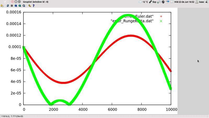

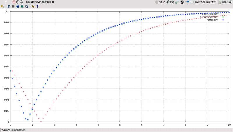

However here is the graph I get if I plot the error of both algorithm in code #3. (See attachment).
So it seems my third code doesn't work as my first 2 codes do. I have absolutely NO IDEA what's going on. I took exactly the same subroutines, copied and pasted. I reset every values for both subroutines so that I don't modify any value for the next subroutine.
I'd love some help here, I'm really lost.

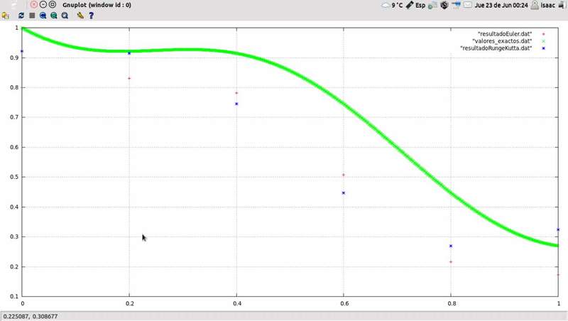

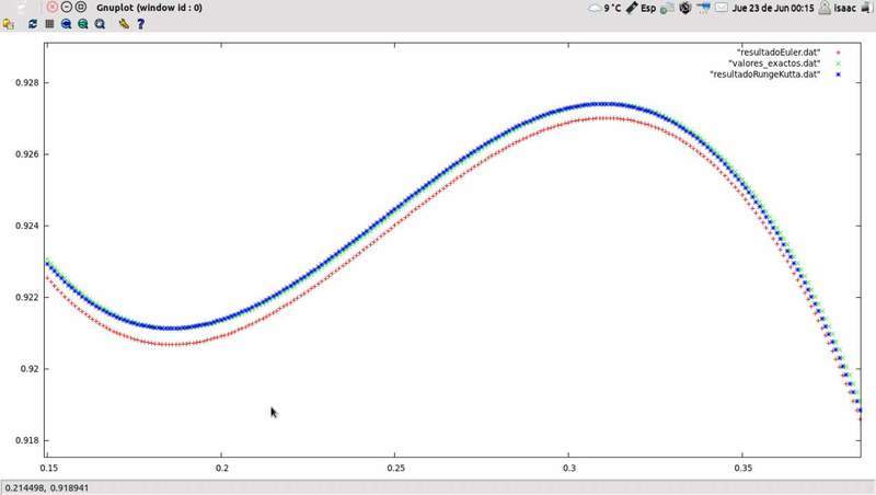

I don't have the errors in my first codes. However I do have the exact values versus the calculated value for each methods.
I send 2 pictures. One more or less general and the other around where I should have noticed the biggest value of error for Runge-Kutta's method.
This is actually convincing myself that Euler's method doesn't seem that bad at all, even with a small h.
I'll try right now with a small h (around 4 or 5 divisions) and post some pics.

Here with h=0.2.

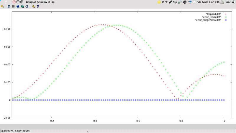

I'm not sure what the issue with the combined programs is, but if you want to try another method, the link below is to a description of an iterative (predictor + corrector) method. You could try doing 4 iterations (the initial Euler + 3 trapezoidals, (y[3])) to compare with Runge-Kutta with about the same overhead. With more iterations, this method will converge to specific values for each step, but since it's a linear approximation for each step (trapezoidal), you still need to keep h relatively small.
Euler_trapezoidal_example.htm
Thank you for your help. I'm going to check this out tomorrow, I'm off to bed now (over 2 am).
My last thoughts for today is that not only the program that merges both codes is wrong for Runge Kutta but even my Runge Kutta (2nd code of 1st post) MUST be wrong.
I hate it when I have an error that is so small that I discover it only after looking for hours on what's wrong :/
Some news:
I've written a few other codes (also with another methods to solve ODE). I plotted the error for Euler, Heun and Runge-Kutta's methods.
One thing I know for sure now is that there's something wrong in all my codes when it comes to Runge Kutta.
For another ODE than the one here, I've tested Runge-Kutta's method along with Heun and Euler. The interval was [0,10] and the step size was 0.1. Euler was more efficient than Heun by a few. Runge-Kutta's error was almost exactly the same as Heun for all points. It means my Euler's method is more efficient than my Runge-Kutta's one.
If someone could spot my error(s) for Runge-Kutta's code, I'd be glad.
I'll be looking at it over and over again but as of now I'm totally stuck. All "seems" good.
Edit: I'm turning crazy! In fact Heun's method as well as Runge-Kutta's one are supposed to be better than Euler's method. So it means I have errors in both Runge-Kutta's and Heun codes! I've rechecked the algorithm of Runge-Kutta and couldn't spot a single mistake.

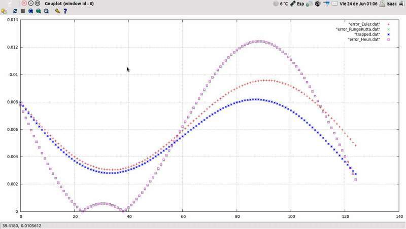

I've added my Heun algorithm for the same ODE. Now that's very weird!
The only difference with the previous post is that now I chose h=0.008 which is slightly smaller than 0.01.
My Heun's method is almost like my Runge-Kutta (but give slightly different values), this is so weird...
Have a look at the attached picture. My code is quite long now, I can post it if you like. But there's definitely something wrong with my Runge-Kutta and Heun's codes.

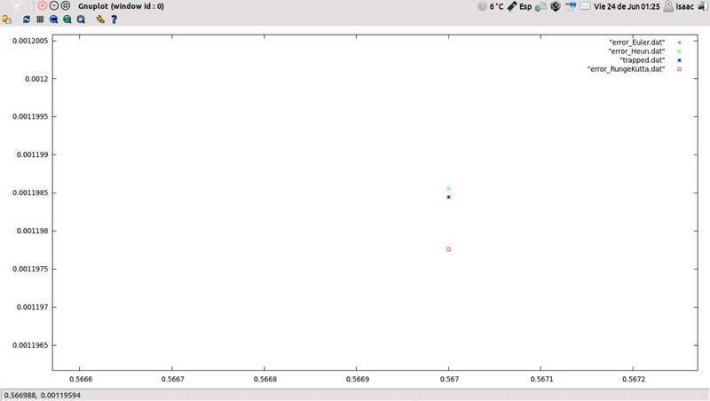

Omg... now I'm clueless. Look at what I get: Runge-Kutta, Heun and your Euler/trapezium seem to give almost the same error. While Euler stands alone.
I really have no clue about what's going on.

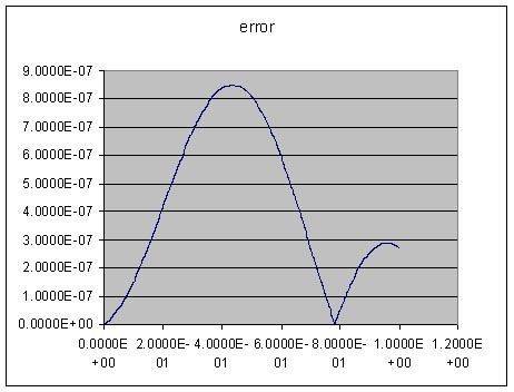

(Note - I updated my response now that I figured out what the problem is)
I see the problem now. You're calculating the exact solution after you've done an integration step, which corresponds to (t+h). In this case, the exact solution needs to also be based on (t+h) and not (t). Move the t=t+h so it's done before you do the exact solution, the code should look like this:
t=t+h
valor_exacto= ...
error=abs(y-valor_exacto)
I used a spreadsheet to test this using the euler + trapezoidal implicit method and these error graphs are the results with step size of .01 and .001. There's still a pattern to the error values, but the maximum error values are relatively small, 0.000085 = 8.5 x 10-5 for step size .01, 0.00000085 = 8.5 x 10-7 for step size .001. The graphs show absolute values, but the actual error values are negative at around .78 to 1.0.

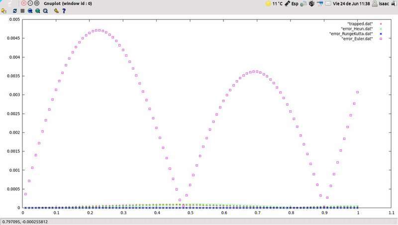

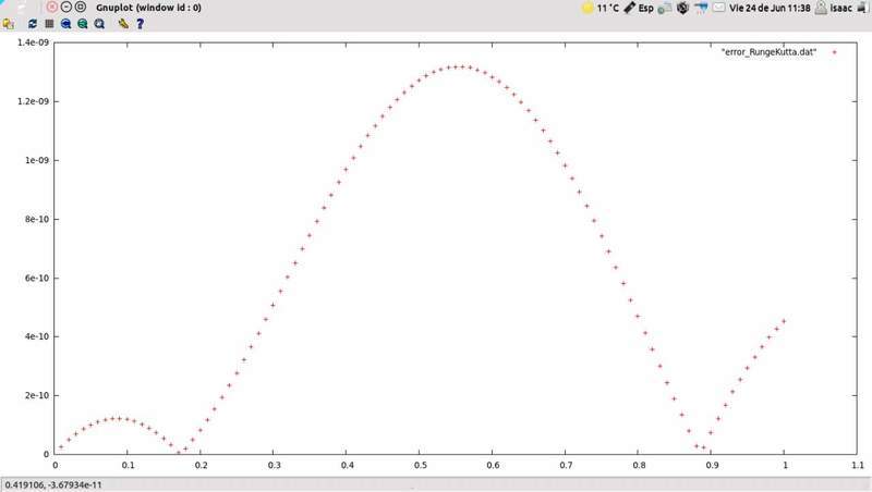

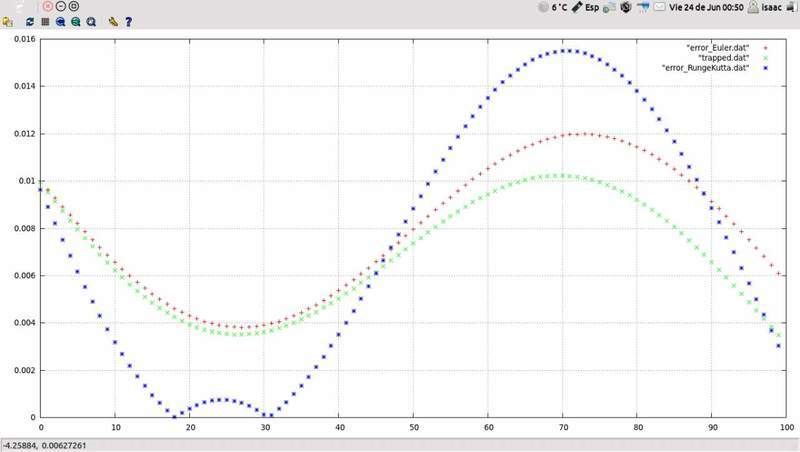

Thank you so much. A huge thanks to you!
I modified all codes. Now I see that Euler's method is much less accurate than all the others. Runge-Kutta's method is by far the most accurate. And your Euler/trapezium and my Heun's method are almost equivalent (same order of magnitude error).
I'll post several pictures.
But to me I was calculating the exact solution with exactly the same value for t I used to calculate y. I don't understand why moving the line t=t+h before "valor_exacto" works. :confused:
I'd never have guessed what the error was... thanks once again.
rcgldr said:
You're calculating the exact solution after you've done an integration step, which corresponds to (t+h) ... not (t)...
I got the same results using a spreadsheet.
fluidistic said:
I still don't understand why what I did was wrong. You said But to me I was calculating the exact solution with exactly the same value for t I used to calculate y. I don't understand why moving the line t=t+h before "valor_exacto" works.
What each integration step calculates is yn+1, using the current yn, tn, and h as input. The initial value y0 corresponds to valor_exacto(t0). Your first integration step calculates y1, which corresponds to valor_exacto(t1), and t1 = t0+h. Note that the Euler-Trapezoidal method and the last term in the Runge-Kutta method also use t+h as input (f(..., t+h)) to calculate those terms.
Ah thanks rcgldr! This makes sense.
26
