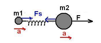

A 2.0-kg mass (m1) and a 3.0-kg mass (m2) are on a horizontal, frictionless surface, connected by a massless spring with spring constant k = 140 N/m. A 15-N force (F) is app0lied to the larger mass, m2, as shown in the figure:
|__m1__|-/-/-/-/-|____m2____| ----------> F
Show that the magnitude of the spring force (spring tension) is given by:
Fs= F(1/(1+(m2/m1))) <---Sorry, do not know how to make that look more asthetically pleasing.

1. Draw the free body diagrams of both the blocks
2. Write down the motion equations of both the bodies.
What do u find then??
'Fs = F/(F + [(F*m2/F*m1)])'
Are not there too many F-s in your formula? F*m2/Fm1=m2*m1. If you meant F*m2/(F*m1), it is m2/m1=1.5, you can not add Newtons to it!
Draw the free body diagram, and see what force acts on m1 if it moves with the acceleration a=F/(m1+m2)
ehild

Are the forces that act on m1 the force of system accelerating from the force acted upon it plus the force of the spring? So a FBD would look like:
| FN --->Fs
[__m1__] -------> a
| Fg
F,x,m1= (m1*a) + Fs
F,x,m2=(m1+m2)*a -Fs
Then doesn't Fs cancel out?
acceleration of m1 is equal to the acceleration of the system which is a = F/(m1+m2)?
Sorry, I have tried this every way and still cannot come up with something that even looks correct. Are my above assumptions correct or am I still missing something?
I show you a proper free body diagram. There is only one horizontal force exerted on m1: the spring force, Fs. And there are two horizontal forces exerted on m2: F=15 N and -Fs. The magnitude of the spring force is the same for both bodies, only the direction is opposite. The bodies move with the same acceleration a.
Newton's equations ∑Fi =ma for both objects:
m1*a = F - Fs
m2*a = Fs.
A force exerted on one body does not act on the other one.
If you add up the equations you get
(m1+m2)*a=F,
a=F/(m1+m2). You got this a already.
Use this a in the equation for m2 to get Fs.
ehild
