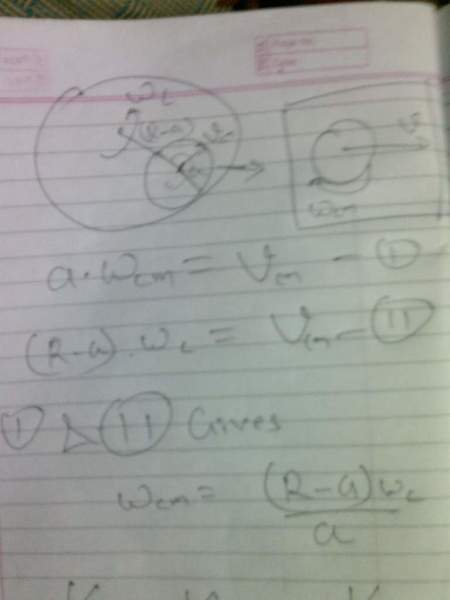

Using the corresponding constraints conditions, calculate the kinetic energy of
1)A homogeneous cylinder of radius a that rolls inside a cylindrical surface of radius R>a.
My toughts: I hope they meants "roll without slipping". Let's consider this case!
[itex]T=\frac{mv ^2_{CM}}{2}+\frac{I_1\omega ^2 _x+I_2\omega ^2 _y+I_3 \omega ^2 _z}{2}[/itex].
Ok I already found out that [itex]I_1=I_2=\frac{m}{4} \left ( \frac{h^2}{3}+a ^2 \right )[/itex] and [itex]I_3=\frac{ma^2}{2}[/itex].
The constraint is that the line of the rolling cylinder in contact with the cylindrical surface does not slide. Mathematically I'm not really sure how to write this down. First, I'd set my coordinate system in the center of the rolling cylinder. (I remember in introductory physics that we dealt with this by setting the relative speed of the cylinders to be 0 m/s, but here I'm not sure)
Considering the axis along the height of the rolling cylinder as the z-axis, I think that [itex]\omega _x =\omega _y =\vec 0[/itex]. While [itex]\omega _z \neq 0 \neq \text{constant}[/itex]. It would be worth [itex]\omega _z (t)= \frac{d \theta (t)}{dt}[/itex] but I'm not sure I should use "theta" as angle. I've read in Goldstein that I should use Euler angles for this, but I have absolutely no idea how.
If the cylinder starts rolling at [itex]t=0[/itex] from its maximum height, [itex]\theta (0)=0[/itex], which is an initial condition for the motion equation of the cylinder.
Any help is appreciated, as usual. :smile:
Edit: Just checked out the picture of Euler angles in wikipedia and I think that instead of theta I should use beta.

It will help to consider 2 angular velocities, that of the CoM [itex]\omega_{CM}[/itex] and that of the smaller cylinder itself [itex]\omega_{c}[/itex]
Now, how about first considering the case where the smaller cylinder is rigidly rotating about at the centre of the larger cylinder. In this case the surface slides. Imagine a rigid arm bolted across the smaller cylinder on a pin at the centre of the large cylinder.
Then if the centre of mass velocity is [itex]v_{CM} = \omega_{CM}(r-a)[/itex] then velocity of the small cylinder scales with distance form the inner cylinder centre and at the surface of the large cylinder it is [itex]v_R = v_{CM} \frac{R}{R-a}[/itex]. This is the relative sliding velocity.
What is the angular velocity of the cylinder [itex]\omega_{c}[/itex]
and what is the total energy of this system? Now when you move to the no sliding condition you have
[itex]v_R = 0[/itex]
So there is an extra angular rotation of the body we must also account for . We want to relate the angular velocity of the CoM to the angular velocity of the small body itself.
2 equivalent ways to relate these
- use the zero velocity constraint to solve for the required body angular velocity
- use the ratio of circumferences to find out how many times the inner cylinder rotates in a single revolution of the larger cylinder

ok, that confused things more than i would have liked... let's just deal with the problem at hand... where the cylinder does not slide
lets start by working in the absolute reference frame and assuming we know [itex]\omega_{CM}[/itex],
R is radius of large cylinder
a that of small
then the velocity of the centre of mass of the small cylinder is
[tex]v_{CM} = \omega_{CM} (r-a)[/tex]
the velocity of the surface (at r= a) is zero as it does not slip
[tex]v_{a} = 0[/tex]
Now consider the dashed reference frame moving with the centre of mass,
[tex]v_{CM}' = 0[/tex]
[tex]v_{a}' = -\omega_{CM} (r-a)[/tex]
Can you find the angular velocity?

I think you are on the right track
the minus sign they are in different direction hopefully you have drawn a good picture
first of the 2 cylinders together, working in the global ref frame (large cylinder is stationary)
- make the contact point at the far right (positive x direction)
- say [itex]\omega_{CM}[/itex] is CCW
- this makes [itex]v_{CM}=\omega_{CM}(R-a)[/itex] in the positive y direction
- mark the contact point as v_a=0
now draw the single cylinder alone, still in the same ref frame, and mark on the same velocities
finally draw the the single cylinder alone, now in the ref frame of the small cylinders CoM velocity, but not rotating
- [itex]v_{CM}'=0[/itex] by def'n
- [itex]v_{a}'=v_a-v_{CM} = 0-\omega_{CM}(R-a)[/itex]
so writing the
[tex]v_{a}'=\omega_c a = -\omega_{CM}(R-a)[/tex]
you get as you had (i prefer considering the little cylinder)
[tex]\omega_c = \omega_{CM}\frac{(R-a)}{a}[/tex]
now to convince yourself it is a reasonable answer
first imagine the large cylinder was instantaneously removed
- this says the small cylinder would move off at speed [itex]v_{CM =}\omega_{CM}(R-a)[/itex] and rotating at [itex]\omega_c = \omega_{CM}\frac{(R-a)}{a}[/itex]
seem reasonable
examine the limiting behaviour
when [itex]a<<R [/tex] the little cylinder cylinder spins really fast<br /> when [itex]a \approx R [/tex] the little cylinder cylinder barely rotates<br /> <br /> try and convince yourself this all makes sense (and feel free to question, though it look good to me everyone makes mistakes no and then;)[/itex][/itex]
the other thing to consider as mentioned before is the ratio of circumference
imagine the large cylinder is unrolled flat, it has a length of [itex]2 \pi R[/itex]
if you rolled the small cylinder along the unrolled length without slipping it would rotate [itex]2 \pi \frac{R}{a}[/itex] radians
when you roll the cylinder back up, this is not quite true and i think you actually rotate only [itex]2 \pi (\frac{R}{a}-1)[/itex] radians, as you remove whole rotation as you go round the cylinder, but you may want to check that (consider the limiting case where R~a)

first of all i must say the question is askin energy not momentum or velocity so you need not go into vectors and coordinate system as energy is scaler...yes u can do it with cooerdinate but it will complicate solution
i will try to do it with superposition principle
"cylinder is moving inside the big cyllinder that means the work done by the normal force is zero":- implies KE is constant:- again IMPLIES :if we remove big cyllinder KE remains same(as force was perpendicular to motion and the friction doesn't work in rolling)
after removing big cyll small cyll moves lenearly and also rotates
now we have to find 'w' (angular vel about its axis afterwards)
and lenear velocity 'v' (afterwards)
NOW the solution:
lets us cosider small cylinders angular velocity(abouts its own axis)= 'w' {remains same}
its speed in circular motion be 'v'= w*(R-a) {after removing big Cyll it is its lenear velocity}
'a' is the radius of small cylinder
moment of inertia along small cyllinders centre axis=1/2(m*a^2)
now total energy= translation KE+ rotational KE
=1/2(m*v^2) + 1/2(I*w^2)
this is the correct solution
if any doubts please ask

I've just seen that the problem is from Landau & Lifgarbagez's mechanics book. The answer given in the book is [itex]\frac{3}{4} \mu (R-a)^2 \omega _c ^2[/itex]. I don't know what mu is though. I've been looking through the book and it doesn't seem to be the reduced mass. It might just be the mass?
So it means my answer is wrong... Where did I go wrong?!
here it is...you are doing some calculation mistake...this question was meant to be done thru superpostion principal only
fluidistic said:
Edit: It should be: [itex]T=\frac{ma^2 \omega _c ^2 }{2} \left ( \frac{1}{(a-R)^2 }+ \frac {1}{2} \right )[/itex].
how did you get this answer? This is Dimensionally incorrect. Didnt you notice it?
Thanks for the reply and for showing me that mu is the mass, for Landau. Actually I think I made a mistake in the answer given by Landau. It should be [itex]T=\frac{3}{4} (R-a)^2 \omega ^2 _{CM}[/itex]. In terms of [itex]\omega _c[/itex] I get [itex]T= \frac{3}{4} a^2 \omega _c ^2[/itex].
Now I understand that it's irrelevant to write (R-a) or (a-R) since you have to square it and it gives the same.
So I reached the answer thanks to you guys. But I must admit I'm having an extremely hard time to "understand" the step when I have to relate the 2 omega's. My brain just can't seem to "simulate" the situation even though I have the expression under my eyes.
I think that [itex]\frac{\omega _c }{\omega _{CM} }=\frac{ (a-R) }{a}[/itex] is a bit more natural to me. I realize I was wrong when I said this implies that [itex]\omega _c[/itex] is smaller than [itex]\omega _{CM}[/itex]. In fact there's a critical value for the radius a so that [itex]\omega _c[/itex] becomes smaller than [itex]\omega _{CM}[/itex], something my brain still have trouble with. This occurs when [itex]a=R/2[/itex]. For smaller values of a, [itex]\omega _c[/itex] is greater than [itex]\omega _{CM}[/itex] (which my brain is OK with) while for [itex]R/2<a<R[/itex], [itex]\omega _c[/itex] is smaller than [itex]\omega _{CM}[/itex] which seems weird to me.
All we have to do is to consider that point of contact remains at rest which gives the required equations between Vcm, Wcm and Wc.

okay
NOW let's visualise:
fisrt i forgot 'Wc' . Just forget that it exists in the question.
i only know Wcm and Vcm:
NOW according to pure rolling Vcm = Wcm * a;
now the only twist is that this cyllinder is rolling not on a plane but in cyllindrical surface
We Find time period(Tc) of the cyllinder = 2*pi*(R-a)/Vcm
THIS GIVES Wc as::
Wc = 2*pi/Tc
= Vcm/(R-a)
=Wcm *a/(R-a)
