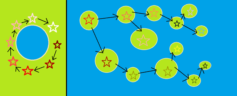

I'm unaware of any ring species event in human history. Ring species specifically occur when a population speciates in a huge circle (e.g. around a mountain range). The Homo genus speciated just because different groups migrated to different areas.
As an example I've thrown together a sketch and attached it. In the left example we have the first species on the far right (the red star). A group of red stars migrate south west around the lake and diverge slightly, but not so much that they couldn't breed with the original population. From this group another smaller group migrates further around the lake and also diverges slightly. Eventually a population arrives from the north west to where the original population still lives but they have diverged so much they are a different species. This is a collection of ring species.
On the right hand example we have a bunch of islands in a sea. Every now and then a small group from a population migrate to a new island. Because of this they diverge and become different species. This is not a ring species.
The defining difference is that when you get ring species every group can mate with it's close neighbours but not with those further away, this is because the neighbours are close enough for interbreeding. I'm not sure if this ever happened to humans, as far as I know we took the route displayed on the right and just moved away from each other.
My god. It's full of stars!
Seriously though, thank you for clarifying this for me.
No problem :wink:
