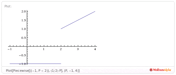

Well, here's a link to WolframAlpha, and the corresponding picture.
Somehow, I don't think this is what you had in mind! :wink:
I have set g=2, k=1/2, and the negative part to -1.
http://www.wolframalpha.com/input/?i=Piecewise[{{-1,+P+<+2}},+(1/2)+P
Can you pinpoint what is wrong with this graph for being a model to your problem?

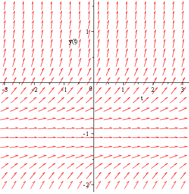

Sorry I like Serena...I'm studying for a chemistry exam I have on Monday. I have a slope field that resembles what I have in mind

I have to admit that I was wondering if you had already lost interest, but for now I'll assume you just had pressing business elsewhere. :)
Now, let's take a look at your attempt.
It seems you've tried to set up the model, calculate, and show the results all in one go.
(My graph was only of the growth rate dP/dt versus population P.)
I presume your field is population P versus time t?
Assuming it is, there are a few things wrong with it.
I'll mention one: apparently the population growth is near infinite at any given time when there is a positive population!
That can't be right.
Can you point out a few other flaws?
Basically that's what modelling is about. You try to find a simple model to fit the facts.
Work it out. See if your model fits. And if it's not complete, add something to your model.
Until you cannot solve it anymore. Then you simplify the model again... :smile:

Yes the field was dP/dt but I have to confess I did it very quickly just to give an impression of what I was idealising and I was trying to relate it to the figures you were using lol.
I definitely do not want an infinite growth at all times, I was idealising two points of equilibrium, exponential growth above the highest point and a curve declining between the highest and lowest equilibrium points and ending at the lowest point. This leads me to believe there has to be a fraction in the model with at least one variable (numerically speaking...it could be a fraction of a parameter over a variable) in the numerator and the denominator--and I am considering that along with elegysix's hint about relating the parameter to a density function, but I have not given this the attention I want to yet.
So we're agreed that we'll first try to find a function that properly describes the relation between current population P and growth rate dP/dt?
(Note that this is a function and not a vector field?)

I wonder now if there is something fundamentally wrong with my reasoning. Isn't a vector field defined by a function? Like the divergence of a vector field is a function? Sometimes it is easier for me to visualise the vector field if I am not sure of the model for the function or sure how the equation would look precisely in space...the vector field helps me to visualise this. I have not learned about vector fields in calculus yet, but "slope fields" in differential equations which I understand to be the same thing.
In a literal sense you are right. :)
A vector field is indeed a function. A special one, where a vector is assigned to each point in the plane.
I was talking more of a regular simple function, where a scalar value (population growth) is assigned to a scalar value (population size).
So we have a simple function f(P) that describes the population growth as a (simple) function of population.
I guess you can also visualize this as a vector field, based on population P and time t.
That is, a vector field that for each time t and population P shows what the growth rate of P versus time is.

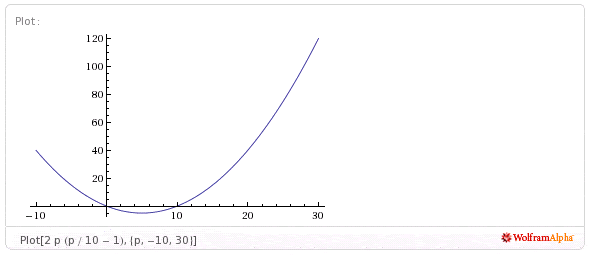

dP/dt = kP((P/g)-1)?
Because of this "However if the population is too small, the fertile adults will have difficulty finding each other when it is time to mate"
so P/g provides a ratio of the current population to the smallest possible population for which the adults can still meet. P < g then dP/dt < 0 if kP is multiplied by (P/g)-1 because if the population is greater than the smallest possible population for which adults can still meet then P/g should be > 1; if g>P then P/g<1 and if we subtract 1 from P/g when g>p then (P/g) - 1 < 0 and dP/dt<0.
I hope this makes sense I am severely lacking sleep and I feel I may be over looking something.
It seems like it could be a possible model...
Looks good.
Could you make a graph?
Since I like pictures. :smile:
And can you solve the DE?

Thinking about the "growth rate" for a single rhino (in a population of many), we might expect it depends on two things:
  1. The probability of meeting another rhino and mating successfully, which is proportional to population density p/A. (Here is where the land area explicitly comes into play.) Call this growth rate (or probability) kp/A.
  2. The probability that the rhino dies, which we can take to be constant for simplicity. Call this g.
So we get [itex]k \frac{p}{A} - g[/itex] as the growth "per rhino", per unit time. Multiply that by p, the total number of rhinos, to get the growth rate of the entire population:
[tex]\frac{dp}{dt}=p(kp/A - g)[/tex]
we can rearrange things and combine the constants, so that A gets incorporated into k, in which case it won't explicitly appear in the equation.
Also, it's instructive to have the factor in parentheses in the form [itex](p/g' - 1)[/itex]. Then we see immediately see that p=g' represents a "break even" point for the population, where births and deaths exactly balance out. Of course, g' here is the g you had written earlier, and it can depend on things like mortality rate and land area.
Hope that helps. By now in this thread we've seen several different forms for the dp/dt equation, but they're essentially the same, just with different definitions of the constants.
