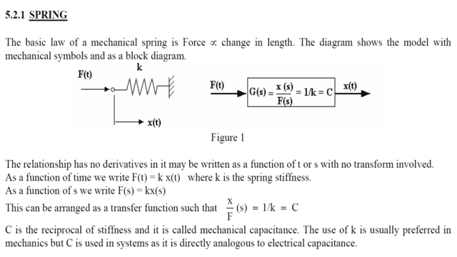

Hello everyone, below I have placed an image of the question, I am quite happy with
the theory. My issue is how it goes from being F(s) = KX(s) to X/F(s) = 1/K
I know to change this into a transfer function it is output (X) over input (F).
However when ever I try i always end up with it = -k/1 ? not 1/K.
This is a very simple problem I know. Would appreciate any help, cheers

I think you are just having a problem with the algebra. If
F = kx, divide both sides by F, thus
1 = kx/F. Now divide both sides by k.
What do you get?
indeed i was thank you for that...its stupid i am happy with laplace, transfer functions, matrix, itegration, differentiation but simple algebra is my downfall!
