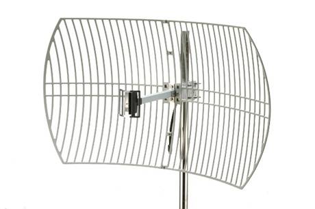

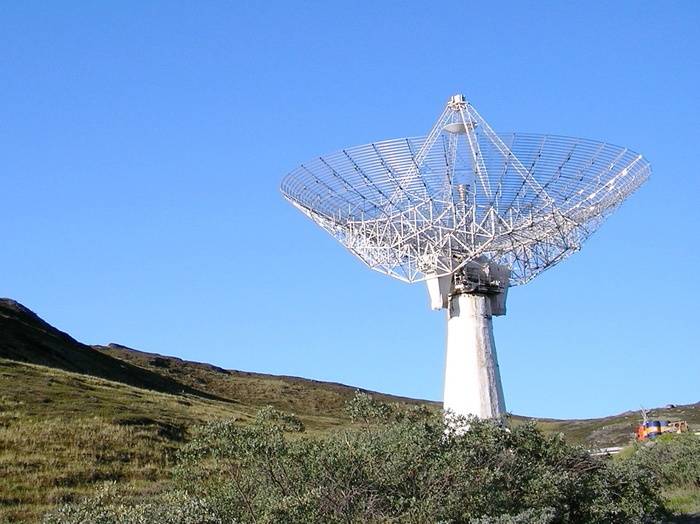

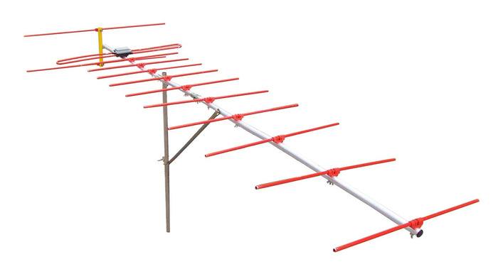

I would like to be able to look at an antenna and understand for example that if the antenna is a wire antenna then it is meant to be used for... as opposed to ring antennas, dish antennas or horn antennas.
And what can I tell from the location angle and size of the dish?
If the dish is simillar to a net what can I tell from the net resolution?
And why do some radar antennas (Navy normally) have a non circular dish with wires going only in one direction? (I guess it is because the sea is a polarier)
Here are a few examples:
And so on
For the first two parabolic antennas:
Wire mesh is used instead of solid material to save weight/cost. As long as the spacing of the wire is less than about 1/10th of the wavelength the antenna is designed to handle then there isn't much difference functionally between the wire mesh design and a solid design.
For the last antenna what you really have is an array of dipole antennas. The most common configuration is a log-periodic antenna where each dipole's size varies so that one antenna array can efficiently handle a range of frequencies. In the picture you included it looks like each dipole is of the same size so not sure what the exact purpose is unless it used for some kind of phase detection (receiving) or increased output stength (transmitting assuming you can get the phases right).
