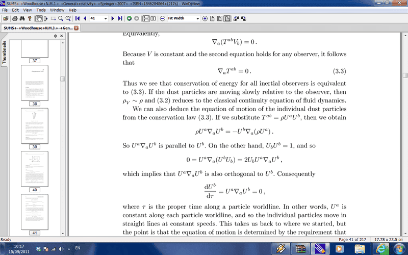

I have next question, we have in the next printcreen the equation:
[tex]\frac{dU^b}{d\tau}=U^a \nabla_a U^b[/tex]
why is this right?
(the printscreen is from the book of Woodhouse in GR, page 34)
Thanks.
Ok, I think I can see why this is right, we pick a frame where [tex]U^a=(1,0,0,0)[/tex].
Clumsy me.
