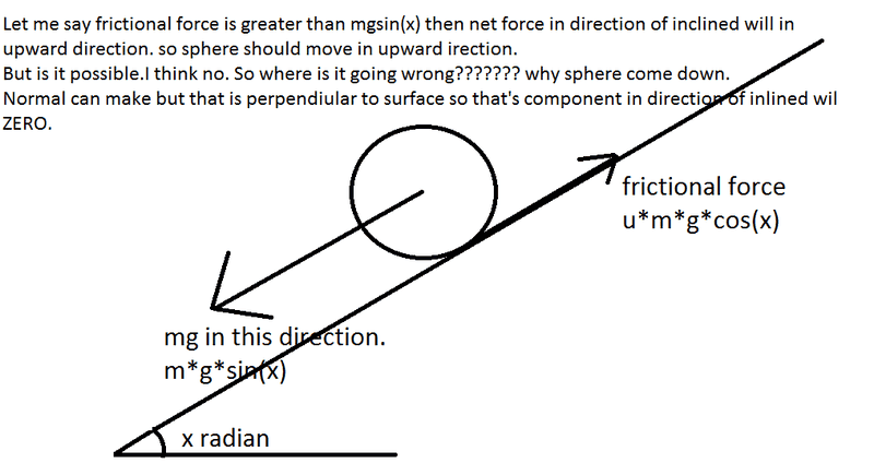

One more question on rotation.
first of all see attachment i want to say that if friction is too large then net force is in direction of inclined in upward direction but from common experience we can say that it will move in downward direction so where is it going wrong. why it moves in downward rather than upward.
If it goes upward then you are breaking law of conservation of energy.You are increasing the energy(potential) of system by itself without external work being done.
Your error is in thinking that friction must equal μmgcosθ. But the static friction will be whatever it needs to be to prevent slipping, up to that maximum value.
I also thinking so.
frictional force will equal to mgsin(t). Net force in direction of inclined will zero and it will in pure rolling motion. Am i correct here? I am in doubt about this.

No, you are not correct. You can figure out the friction force by applying Newton's law to both translation and rotation.
If you call the friction force F, then the net force will be mgsinθ - F. That same force F will also produce a torque on the sphere. By applying Newton's law and the condition for rolling without slipping you can solve for F.

Well I didn't understand the significance of 't'. It's okay that mu(coefficient of friction)*g*sin(x) is limiting case and that's what you have to consider. If you can explain me the physical significance of 't'(that's your mistake) then it's okay what you have done(For any middle case).

friend I am doing the same thing but about the instantaneous of rotation. You may not understanding my way because i skip many step.
If I do in the way you say then.
torque about the center of
Fr=mr2a
F=mra
F=mA.
Now
mgsin(t)-F=mA
since mA=F
so mgsin(t)-F=F
2F=m*g*sin(t)
so F=0.5*m*g*sin(t).
t is angle of inclination of incline, a is angular acceleration, A is linear acceleration.
Am i correct??

t is angle of inclination of inclined plane. In figure it is x. that's Variable mismanagement.
So am i correct now?
mA=F is final limiting case.I thought you wanted to calculate for case in between

Realize that you are solving for a special case where I = mr2, a cylindrical shell. But given that, you are correct.

No. The friction force needed to prevent slipping will depend on the rotational inertia.
Don't use the same symbol for radius and radius of gyration.

:confused: Answer what? Do you not see where you assumed that I = mr2? If you want to be more general, use I = mk2. But then your answer will be in terms of k and r, which will no longer cancel.
If you pick the object you want to study, then you can compute its acceleration and the required friction.

See my post #15. You've already solved for that special case and I agree with your answer.
