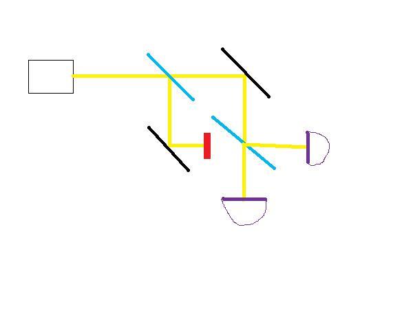

If a single photon light source shoots a photon through the "attached" path. What is the percentage of the photon will make it to each detector. The light source is the box, the photon trajetory is yellow, beamsplitter is blue, mirror is black, detectors are purple, and obstacle is red. I think because of the indistinguishabillity principle, the photon will go 50% to each detector because there is a physical disturbance in the trajectory(obstacle). Any thoughts?
In case of perfect beamsplitters: 25% photons would go to each detector and 50% would be lost.
Not because of the "indistinguishabillity principle", but just because there is no interference in such setup, and each BS just divides the stream of photons into two with equal probabilities.
There is nothing more in such experiment than first BS reflects half of the photons toward the obstacle, and the second sends half of the remaining photons to one detector and the rest to other.
Thank you! So if the obstacle was taken away then 100% of the photons would end up being reflected-transmitted/transmitted-reflected and thus all ending up hitting the detector on the right. This is due to interference. Right?

Yes, if you analyze what is happening at the level of probability amplitudes which can interfere, then it doesn't matter if those same amplitudes are referring to more photons in the same states, they'd just be larger amplitudes doing all the same things. But photons in different states could mess up the coherences and destroy the interference pattern, which is why this sort of experiment is done with lasers (the photons are then in the same state).

This is certainly common interpretation that interference determines photon path at beamsplitter.
But just as certain you would run into serious problems if you will try to interpret this experiment the same way:

If you block one arm, then the experiment establishes photon path-- the other arm.
In non-blocked case you assign two different descriptions for two paths and then determine relative parameter (phase difference) between two descriptions. I can't see how you can do that without resorting to "path".
If you have two paths, then the experiment does not establish which path, and so the (unique) path taken simply does not exist.
