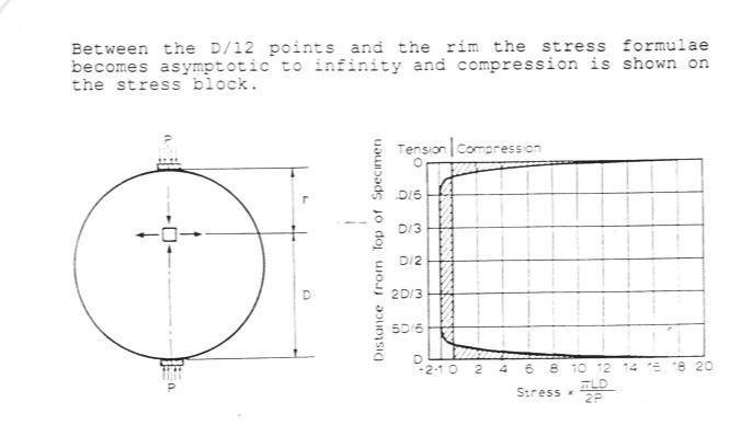

ndriana
I thought I understood it cause I always had the right answer ever since I learned about it.
But now my friend asked me a question about why does a piece of chalk break if you put a heavy thing on it, say a car.
If we just think about action and reaction, the forces have to be along a vertical. So where are the horizontal forces, that pull the chalk apart, from?
I don't there are actually any forces operating in the horizontal direction, the cracking of the chalk comes from either stress or strain (these differ slightly and i can't recall which is which)
obviously there is a certain force that the chalk can withstand, this depends on intrinsic properties such as density, material, and also on length and thickness. When a force is applied that is less that the force required to break the chalk, the normal force simply 'pushes' in the opposite direction and it seems as if the chalk has taken the weight.
If a force is applied that exceeds the breaking force, the normal upwards force can no longer counter the downward weight so the chalk snaps and the 2 new ends (the ones created from the cracking of the chalk)cl will move in the direction of the applied force.
Think of it as a 'tug-of-war' when the normal force can no longer push against the applied force, the applied force wins and so the chalk breaks in that direction (or rather the crack makes its way through the chalk in that direction)
Actually, this has relatively little to do with Newton's 3rd law and more to do with the transformation properties of tensors. If you "squeeze" chalk along one direction you are loading it in what is called "uniaxial stress". Because of the way the stress tensor transforms, if you look at a plane through the chalk inclined at 45º you will find that the chalk is under shear strain in that direction. In other words, by not applying compression uniformly you are causing shear strains. Chalk is particularly weak in shear (that is why it writes on blackboards) so it fails. It is the very fact that you are not applying the horizontal forces which causes it to fail.

The failure mode of the chalk specimen depends upon its shape.
Chalk is a brittle material and a square cross section does indeed fail in diagonal shear under a crushing load.
However if a round piece of blackboard chalk is meant this fails in horizontal tension, not diagonal shear as shown in the attachment.
