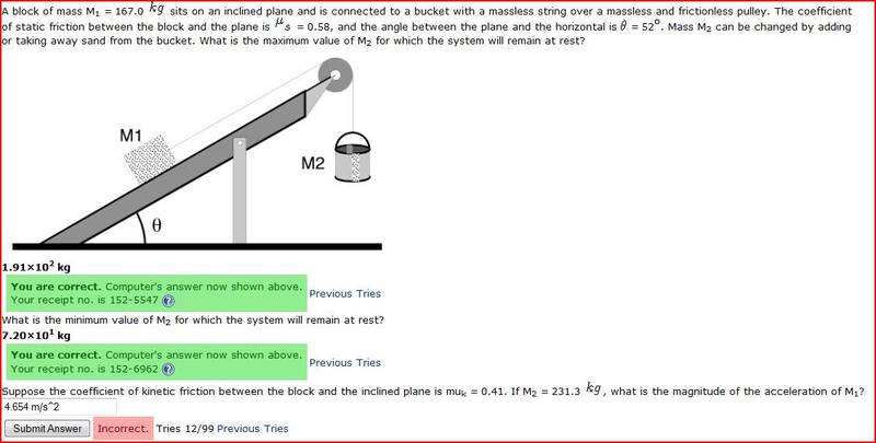

Hello,
I have an urgent question due soon, and I have no idea how to solve it.
I have all the answers and they turned out to be right. I just need help with the last one.
Here is what I did:
Fk = MuK N
Fk = 0.41 (167)(9.8)
Fk = 671.006
F = ma
671.006 = 167 a
a = 4.018 m/s^2
However, it's not the right answer. Please help!

I don't see a cos(θ) term in your equations. That is needed when calculating the effective normal force on the ramp.
Ok so let me redo this.
Fk = MuK N
Fk = 0.41 (167)(9.8)cos52
Fk = 413.11 N
F = ma
413.11 = 167 a
a = 2.47 m/s^2
The answer is still wrong. I am pretty sure I messed up because I didn't use the M2 in part c that they give me.

You are working the first problem of the 3, correct?
The first equations where you calculate Fk are correct.
But I don't understand what you are doing in the 2nd set of equations. The force of tension up by the rope on the M2 bucket is balancing what force down on the bucket?
I'm solving on the last problem. Sorry for the confusion.
I am using the second set of equations to solve for acceleration of M1.

Ah, no wonder I was off in the weeds :-p
The mass that gets accelerated (by the difference in the forces) is the sum of the two masses. Does that help?

In the 3rd question, you have more force than needed to break M1 loose and cause the M1 & M2 combined masses to accelerate to the right & down. The acceleration is defined by the sum of the forces (they are in opposite directions), i.e., the tension in the rope, and by the sum of the two masses, since that is what is being accelerated.

The 413.11N is the force due to friction on M1. It is not the sum of the forces acting on the two bodies together.
The better way to write the equations would be like...
[itex]\sum F = M_{total} a[/itex]
The sum of the forces is the friction force on M1, and what force on M2?
The total mass is what? And that gives you what resulting acceleration for the system of M1 and M2 tied together?

If you draw a FBD for M2, the tension up is due to the frictional force from M1. What is the force down on M2 due to?
Gravity.
Ding ding ding. :biggrin:
So draw the FBD for both masses, and show the forces that act on the system. The imbalance in those forces is what causes the acceleration of the two masses together.

so Fgrav = mgsin52 = 231.3(9.8)sin52 = 1786.22 N

There is no sin() involved in the force of gravity on M2. It points straight down, directly opposing the tension in the rope due to M2's frictional force...
This problem is so frustrating. After so many attempts, and my answer is still wrong. please tell me where I am messing up.
Fgrav = mg = 231.3(9.8) = 2266.74 N

Please go back to your post #19 and make the *two* changes I suggested to your equations. Fix the value of the M2 weight, and make sure both masses are represented in the sum of the masses.
I edited it, and I got 4.65 m/s^2. Is that the correct answer?

Since the rope is taut, and the masses are both moving, we should be able to use the sum of the masses and the sum of the forces to figure out the motion of both (the magnitude of the acceleration for both masses is the same).
I'm not sure what we are missing. How many sig figs does this software generally want to see?
I get:
[tex]a = \frac{\Sigma F}{\Sigma M} = \frac{2266.74N - 413.11N}{167.0kg + 231.3kg} = 4.654 m/s^2[/tex]

Can you repost a screenshot of what the screen looks like now? Maybe we are missing something in the way the question is asked...
