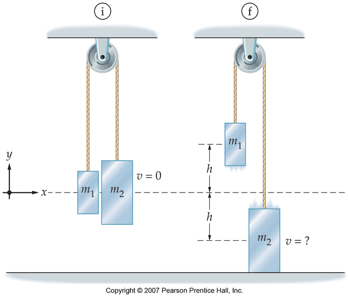

The two masses in the Atwood’s machine shown in Figure 8–23 are initially at rest at the same height. After they are released, the large mass, m2 falls through a height h and hits the floor, and the small mass, m1rises through a height h. Find the speed of the masses just before m2 lands if h = 1.2m, m1 = 3.7kg and m2 = 4.1kg
E=Eo
Ug=mgh
K=(1/2)mv^2
m1*g*y +m2*g*y = (1/2)*m1*v^2 + (1/2)*m2*v^2
I factored outed g*y and (1/2)*m*v^2
g*y*(m1 + m2) = (1/2)*(v^2)*(m1 + m2)
I canceled out (m1 + m2)
g*y = (1/2)*v^2
g*y = (1/2)*v^2
2*g*y = v^2
√(2*g*y) = v
√(2*9.8*1.2) = v
This is apparently wrong:
4.85m/s ≈ v
first define the reference level for the potential energy... what level have you chosen ?
I would like to set the reference level at where the dotted line is (where v=0).
ok, so that means your initial total potential energy is zero. Also initial total kinetic energy
is zero. So total initial energy is zero. What about the final configuration ? The left block has climbed up distance h , so its potential energy is [itex]m_1gh[/itex] and the second
block is gone below the reference level. so its potential energy would be
[itex]-m_2gh[/itex]. What about their kinetic energies ? Find that expression and use the conservation of energy theorem, which implies that the total initial energy must be equal to the total final energy...
