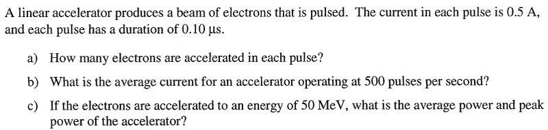

Oshada
40
I'm at a loss as to starting the problem. Any help is appreciated!
What is the relationship between current and charge?
i = dQ/dt, but I can't figure out how to derive/integrate here :(
No integration is required. You're given the current (0.5 A) and the time that it flows for each pulse (0.10 μs). If 0.5 A flows for 0.10 μs, how much charge has moved?
Thank you very much, I forgot the elementary relation Q = it. I got 3.1 * 10^11 electrons for a) which is the right answer :)
For part b), do we just divide average current per pulse by number of pulses per second?
The average current will be given by the total charges moved in a second, divided by one second. You've found the charge q moved per pulse, and you know the number of pulses per second, so...
Yup, got it. Part c) ?
What are the units of power? What's the energy per charge? Per pulse?
Again, I have forgotten that electrons having an energy of 50 MeV have been accelerated across 50 MV. Thanks!
