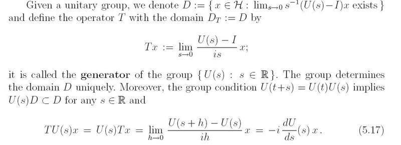

The exponential is defined as a power series only if H is bounded. For H bounded (which is rarely the case in QM) the proof is trivial (purely algebraic). For the unbounded case, it should go like this. From the theory of Galilei group representation, one derives that time evolution of pure states is provided by means of a strongly continuous group of unitary operators U(t) and we agree to denote by H the generator of this group and call it Hamiltonian, which is time-independent, if one's working in the Schrödinger picture. To show that the generator commutes with U(t), we start from the definition of the generator (H) and I have attached a paragraph from Blank et al.
The fact that H as the generator is self-adjoint represents the conclusion of the theorem of Stone, which is found in most books on functional analysis.

Cool. I knew that Stone's theorem is what you use in the unbounded case, but I have never studied the details. I wasn't aware of the stuff mentioned in the attachment.
